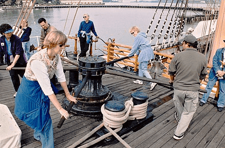

You might ask yourself why the pikes in this picture are long.
'They' didn't invent torque before there was a need to. No one said "I know, let's take Force times Perpendicular Distance and call it Torque"
What was found was that long levers need less force when applied against short levers. (Obvs, of course) An empirical rule was postulated and then confirmed by countless measurements and observations. The principle of Moments was born. Torque was the word which described the effect of levers.
I don't think there can be any actual proof of this - any attempt would involving just re-stating an idea and then re-stating it in a different way - proving nothing. It's just like Momentum (another quantity that we have found to be always conserved (when you get rid of all the practicalities of an experiment)
In the case of many so-called Machines, the geometry of the thing gives a theoretical 'Velocity Ratio' and that's often confused (even PF is incredibly sloppy about this) with 'Mechanical Advantage', which is the measured ratio of load one effort. It always falls short of VR because of Inefficiency. People ignore the dead weight of lever arms, friction and the weight of pulley blocks. The MA of that Capstan in the above picture will be hopelessly worse than the VR might suggest.
The MA of that particular capstan is zero because there is no load. No rope is attached. The tourists are busy doing nothing but turning the dead weight.
Their eyes would certainly be bulging a bit more if a chain and anchor were attached. (They are working with an MA of 0!)
"Yo, ho, ho, me hearties! And a big, big welcome to this nautical version of the dude ranch! Heave away with a will, now, me lubbers, if you don't want to feel the end o' this cat o' nine tails!"
