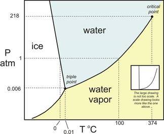

Sublimation and evaporation occur when the partial pressure of water is less than the vapor pressure. Boiling occurs when the total pressure is less than the vapor pressure.
It helps to look at a phase diagram.
(Click on the image for a large version.)
Notice that water ice can go directly from the solid phase (ice) to the gas phase (water vapor) if the pressure is low enough. This is called "sublimation." The partial pressure of the water in the atmosphere just has to be below the vapor pressure for sublimation to occur. (Aside: This is why old ice cubes get so rotten.) For temperatures below the triple point temperature, the vapor pressure is the pressure at the boundary of the curve that separates ice and water vapor.
Liquid water evaporates when the partial pressure of water in the atmosphere is below the vapor pressure. For temperatures above the triple point temperature, the the vapor pressure is the pressure at the boundary of the curve that separates water and water vapor.
Boiling occurs when the total pressure is less than the vapor pressure. The difference between water at just under the boiling point and just over it is quite profound. In the first case, there's a good amount of evaporation, but this only occurs at the air/water boundary. In the second case, even the water at the bottom of the pot can't sustain being liquid. Boiling occurs throughout the water while evaporation only occurs at the surface.
