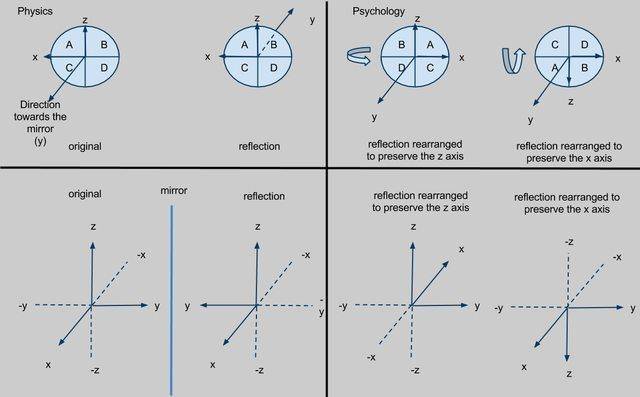

I made this some time ago:
It might help visualise what other posters were talking about.
The point of making the diagram was to show that the left-right inversion perception is just as arbitrary as up-down inversion, and the particular preference humans exhibit is likely due to our lateral symmetry. An imaginary creature with an up-down symmetry only would insist that a mirror inverts those two directions, an a creature with no symmetry would probably never even think a mirror could invert anything but the front-back direction.
If you are precise, you will find that the mirror does invert vertically in the same matter as it does for left-right. What do we mean to say the mirror inverts left and right? Well, if I rotate the image in the mirror about the z (up) axis and try to line it up with myself, the left and right sides would be switched. Similarly, if I rotate the image about the horizontal axis (the x-axis in the above post), I would find that my head and feet are swapped. But people don't think to make that rotation as much as they do the first one.
