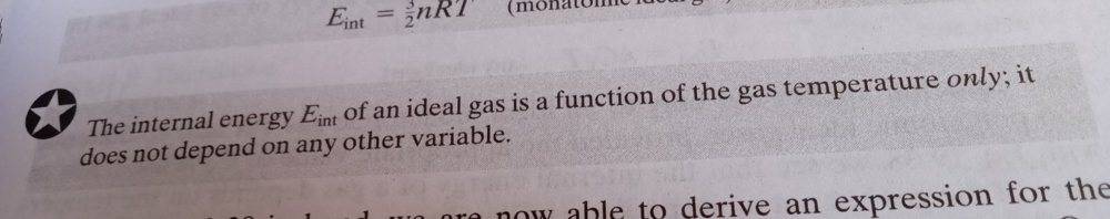

Can anyone please give the reason of the line written in the box.
It follows directly from the fact that for a non-interacting gas the equilibrium phase-space distribution is the Maxwell-Boltzmann distribution,
$$f(\vec{x},\vec{p})=\frac{\exp[\mu/(k_{\text{B}} T]}{(2 \pi \hbar)^3} \exp \left (-\frac{\vec{p}^2}{2m k_{\text{B}}T} \right).$$
From this the total number of particles and internal energy follows
$$N=V \exp[\mu/(k_{\text{B}} T)] \int_{\mathbb{R}^3} \mathrm{d}^3 p f(\vec{x},\vec{p}), \\
U=V \exp[\mu/(k_{\text{B}} T)] \int_{\mathbb{R}^3} \mathrm{d}^3 p f(\vec{x},\vec{p}) \frac{\vec{p}^2}{2m} = \frac{3 N}{2} k_{\text{B}} T.$$
For a fixed number of gas particles the internal energy only depends on temperature, not on volume. The reason is that an ideal gas is defined as particles that interact only via short-ranged interactions with the average inter-particle distance being large compared to the range of these interactions, i.e., most of the time the gas molecules are free particles and thus you can squeeze them to a certain extent without any work due to particle interactions. The only work you have to do is against the gas pressure.
You mean why you reposted your initial question in photographic form? No idea.
It is usually a very good approximation. But is doesn't work for astronomic scales.
