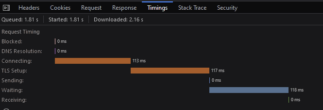

I'm not sure what might be wrong with your Maple/Mathematica etc. set-ups but Wolfram Alpha turns it round in 112 ms ignoring network latency.
Baluncore said:
Single or double precision?
All JavaScript results are IEEE 754 double precision (64 bit).
How did you get the time 112 ms?
It's the "results" path that delivers the response: 118 ms this time. The rest of the time loading the page is downloading fonts, graphs etc.
Edit: I suppose it may have cached the calculations earlier, but this is in the right ballpark - here it is on my desktop (a bit newer i7 than @Baluncore's).
