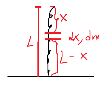

A chain of total mass M and length l is suspended vertically with
its lowest end touching a scale. The chain is released and falls onto
the scale.
What is the reading of the scale when a length of chain, x, has
fallen? (Neglect the size of individual links.)
F = dp/dt
F = ma
I have seen the solution for this problem but still there are some things I do not understand and would like clarification.
In the equations below I understand that we use the chain rule on m and v but what I don't understand why m*dv/dt is 0, I don't think is because the acceleration of dm is 0, since I assume dm is free-falling then it has acceleration g.
Equations: F1 = dp/dt = d(mv)/dt = v dm/dt + m dv/dt, followed below by v dm/dt ≠ 0 and m dv/dt = 0.

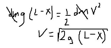

Also, when I tried solving for the speed of a segment of chain dm using conservation of energy, I got for v = sqrt(2gx), which is correct based on the solution I saw, but could we use for the height displaced L-x, instead of x? I tried to solve it with L-x but I got the wrong solution. My assumption here was that an element dm located at a height L-x from the floor/scale starts from rest and reaches the speed below.
Hand-drawn diagram of a vertical chain hanging above a horizontal floor line, with a red length L on the left, a red x marking the top portion, a small segment labeled dx, dm, and the remaining lower portion labeled L - x.
Handwritten derivation: d/dt[m g (L-x)] = (1/2) dm v^2 with dm crossed out, then v = sqrt(2g(L-x)).
View attachment 278855View attachment 278856
You are given ##x## as the length of chain that has fallen. Why change that round?
Some problems I don't understand well, I usually try to solve them in different ways, this helps my understanding of the problem that is why I wanted to use L-x. Anyway, thanks for your approach on this problem, it helped me look at it from another perspective.
