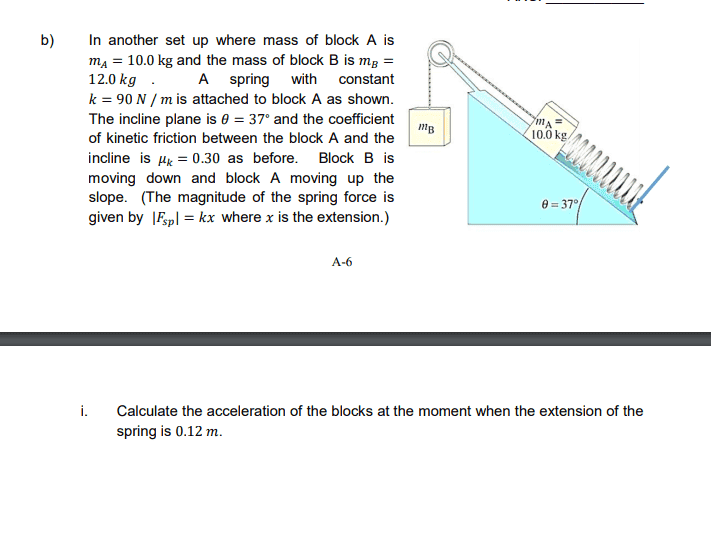

In another set up where mass of block A is ๐‘š๐ด = 10.0 kg and the mass of block B is ๐‘š๐ต =12.0 ๐‘˜๐‘”. A spring with constant๐‘˜ = 90 ๐‘ / ๐‘š is attached to block A as shown. The incline plane is ๐œƒ = 37โˆ˜ and the coefficient of kinetic friction between the block A and theincline is ๐œ‡๐‘˜ = 0.30 as before. Block B is moving down and block A moving up the slope. (The magnitude of the spring force is
given by |๐น๐‘ ๐‘| = ๐‘˜๐‘ฅ where ๐‘ฅ is the extension.)
For Ma(perpendicular) = FN - Magcos(titre) = 0
Ma (Parallel) = Fsp + T - Ffriction - Magsin(titre) = Ma(a)
For Mb: Mbg - T = Mb(a)
Fsp = 90 x 0.12 = 10.8
Ffriction = Magcos(titre) x 0.30
I got the answer 2.09ms2 when the correct answer is 1.11ms2. What am i doing wrong here?

Chestermiller said:
Isn't the spring force opposite to T?
But wouldn't the spring force push the block forward?
It says the spring has an extension of 0.12m.
When the spring extends, wouldn't it exert a force in the same direction as the tension force?
When you stretch a spring, doesn't it pull back on you in the opposite direction?
Is an extended spring under tension or under compression?
Oh, means to say when its extended it will have a tension pulling it back and if compressed there will be a force pushing the block forward?
tension.
Yes.
