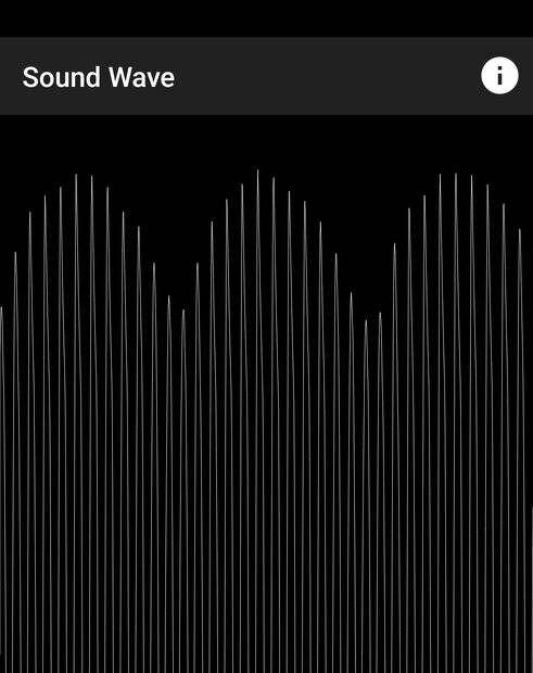

Adding to the above, I see in the video in the OP, it states "By playing a note and simultaneously singing a quint to it, the tone will sound an octave deeper". A musical quint is 1.5x the frequency of the reference note. So my example of 400 Hz note, and singing 600 Hz, fits this scenario. And 200 Hz is an octave deeper, so it is a sub-harmonic, and a difference frequency as well.
I suspect it will always be a difference frequency (based on the amplitude modulation effect), it just happens to be a sub-harmonic as well in this case.

This is a good point! It's actually a difference frequency generally speaking. It just happens to be a subharmonic whenever the frequencies form a nice ratio (like 3/2, 4/3, and so on)

Yes, I can say with certainty that it's a difference frequency. To address your worry about the voice having too many harmonics: It doesn't necessarily have to. Like written above, singing quietly and in falsetto leads to almost a sine wave.
I put my phone near my mouth and played a tone at, say 800 Hz, while singin. If you ask me, everyone has a phone and everyone has vocal chords, so this as easy to replicate as it gets and you can feel free to do it if you doubt the results (if no one is around xD). Note that the scale is logarithmic, so the harmonics are not nearly as strong as they appear to be, but yeah it's hard to get rid of the first harmonic in the falsetto.
from bottom up: sine at 800Hz; falsetto voice at 800Hz/1.5; both
To prove that this is indeed a difference frequency, I simply increased the pitch of my voice and, as you would expect, as the fundamental frequency of my voice got closer to 800Hz, the difference frequency dropped. And you see another difference frequency that increases, as the first harmonic of my voice gets further away from 800Hz.

It's not as complicated as you think, the signal generator is just my phone playing a sine wave from an online tone generator. That's the whole setup, my mouth and my phone near it.
Edit: once again, this setup doesn't include the clarinet. This is what makes it reproducible. While only a few people have a clarinet, all people have vocal chords and a phone

Sure, it is a theory. I'm not gonna repeat myself, this is why I think it happens:
Daniel Petka said:
Ok I might have an explanation for all of this. This comes a bit late because I focused on Uni instead of this peculiar effect.
I tried another experiment: sending a single frequency into my mouth cavity while singing a note (Don't try this at home unless no-one is around lol)
And guess what, this still creates a subharmonic. Doing this with a flute doesn't.
Which leads me to believe that the reason why you hear a subharmonic when singing while playing a flute is that the sound from the flute gets into your vocal chords.
The flute is just a resonator so it's not surprising that a single frequency that's not resonant doesn't do much.
The reed is different.
The nonlinearity or the switching of a diode can be eliminated by singing quietly and putting the sine wave into the vocal chords.
The most simple explanation that I could come up with is that higher air velocity => higher amplitude. Sinusoidally varying air velocity (sound) => sinusoidally varying amplitude, multiplication of the 2 sinusoids.
I tried to simulate this in Python by multiplying a recorded clarinet .wav file by this DC air and AC perturbation, basically
Growl(t) = clarinet(t)*(1+cos(wt))
Where w is the angular frequency one fifth above the clarinet's fundamental. The resulting sound is very close to the real thing.
Edit: I just did it with a subwoofer playing at 800Hz while not even singing directly at it. I doubt that the voice had any effect on the sub

Very few things in science reach safe conclusions, but I would say it's safe to call this AM.
I don't quite see why perception matters here - the witness is my phone, not my ear.
