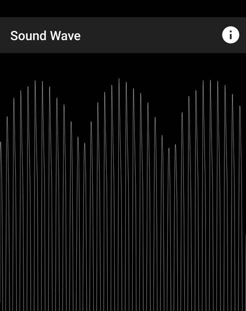

  • #61
Daniel Petka said:
Very few things in science reach safe conclusions, but I would say it's safe to call this AM.
I don't quite see why perception matters here - the witness is my phone, not my ear.
It's true to say that the amplitude varies but are you sure that the envelope shape is identical to (one of) the inputs? Is there no distortion? If you want to call it AM then that would be a 'happens to look like AM in this case'. A lot of the effects you get from interaction between the instrument and the player are not just simple AM. What is your basis for saying it is? What you are getting is intermodulation so why not call it that? Covers all bases and avoids inconsistencies further down the line.
Also I read the thread in terms of the effect on the player as much as on the listener. There is a lot of subjective here.
  • #62
Yes, the envelope has the same fundamental frequency as one of the inputs. The other frequencies are contained in the spectrogram I posted. The (falsetto) voice does have a strong first harmonic that generates its own sum and difference frequencies. This generation of intermodulation products is inevitably linked to amplitude modulation via the product rule.
"Intermodulation (IM) or intermodulation distortion (IMD) is the amplitude modulation of signals containing two or more different frequencies, caused by nonlinearities or time variance in a system. " source wikipedia/intermodulation
This nonlinearity that causes it is unknown. Above I speculated that it's due to the Bernoulli principle and I'm unlikely to build a machine so I'll probably leave it there.
  • #63
That's only half a definition but could be applied in some cases. This link is a bit more informative and the sketch diagram shows that we have much more than a carrier plus a pair of sidebands involved.
