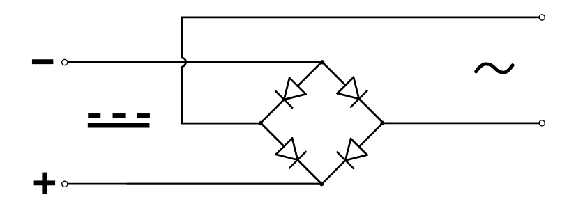

  • #51

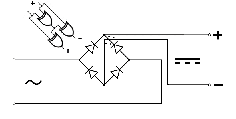

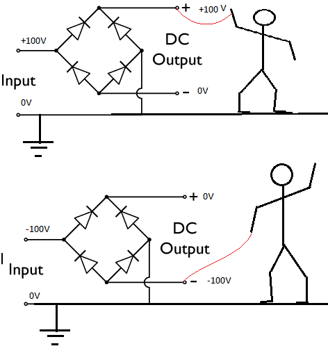

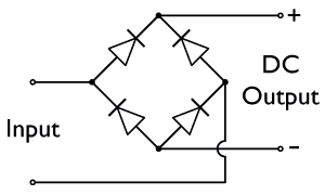

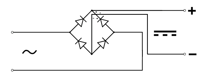

I wonder if anyone can put up a diagram of how this is done. It's a new one on me and I haven't been able to figure out how it would work.
sysprog said:
Although AC itself ... has no polarity, the direction of current flow, especially in a non-isolated circuit (e.g. one in which neutral is connected to ground), can be important -- e.g., an appliance that has an internal fuse should have the hot side go directly to the fuse first, rather than letting an excess current run through the rest of the circuit first and then letting that excess current blow the fuse -- I think it's a good practice to put 4 diodes in a square formation at the start of the power connection to ensure that the current flow will be in the desired direction even if the electrician wired the outlet with the wrong side hot.
  • #52
It is call a diode bridge:

Since this thread has been revived, I wanted to post a follow-up about polarized 2-prong AC Mains plugs in the US. I had previously used the 2-prong power cord connected to a light bulb socket to illustrate why polarized plugs are important:
berkeman said:
Here is a hint. In the US, by Code the Neutral wire is connected to Earth ground at the breaker panel (at least in home installations). Why do you think it might be important for this lamp's 2-prong power cord to be polarized?
https://li1.rightinthebox.com/images/190x250/201609/dyfw1473216613785.jpg

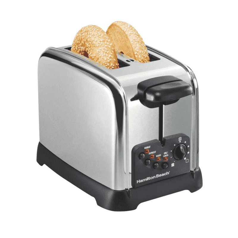

But a couple days ago I noticed that my toaster also has a polarized 2-prong power plug, and realized why. Thoughts? :smile:
https://images.homedepot-static.com...ilton-beach-pop-up-toasters-22790-64_1000.jpg
  • #54
The outwardly friendly electric toaster is really a deadly accident waiting to happen. The elements are so easy to touch with a metal table knife when the toast gets stuck. It's amazing that type approval still applies. The only 'safety' feature is to make sure that the element wires at the top end, near the slots, are at the Neutral End. That helps to ensure that a knife will only have a relatively low voltage on it. A tingle and some sparks should be the limit of the 'accident'. But it does require that L and N ('polarity') connections are carried through from mains socket to the elements.
I believe I have seen a toaster with IR elements in glass but never bought one. That should be a required feature in all new toasters.
  • #55
Yep, but the polarized plug also ensures what about the on/off switch? :smile:
  • #56
Double pole switch IIRC.
Edit: They are very popular for throwing into a victim's bath in crime movies. :wink:
  • #57
Well yes, it is.
But I thought they were talking about AC and ensuring that one of the outputs remained at ground potential whichever way the input was connected.
Here it looks to me that whether this cct is connected to AC or DC, neither output is safe unless you know which input is grounded.
For AC, of course, neither output is safe whatever you do! You might prefer to use a transformer, or keep well insulated from both outputs.
BTW I use 100 V just for ease of typing. It might be 250 V or whatever.
I still wouldn't fancy 100 V, if I happened to have my other hand on a good ground (as is made mandatory here, IMHO, by equipotential bonding of random bits of metalwork.)
  • #58
It is, so your diagrams should show the negative output of the rectifying bridge connected to Earth Ground.
  • #59
