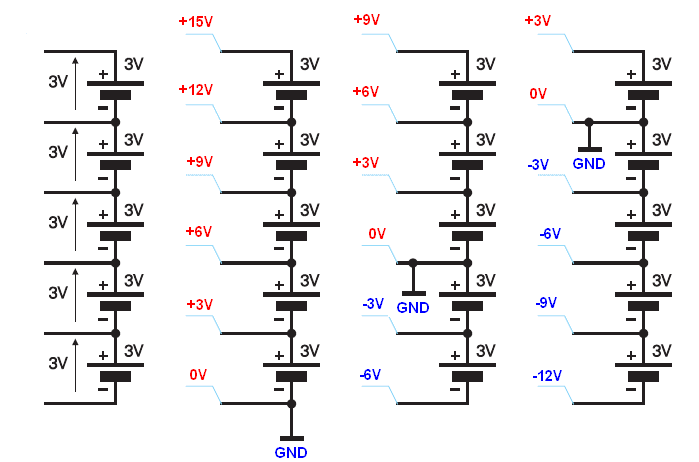

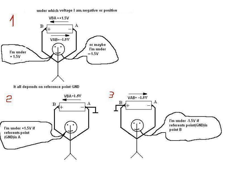

In an AC circuit, we know that the polarity inverses, and what i know is that the flow of current also will therefore inverse.. which means that the live will become negative and the neutral will become positive.. What i can't understand is how the polarity inverses but the live is still the hot wire and the neutral stays the cold one? i mean the polarity of each should have been reversed..
I need a very good explanation of it, I've asked many people the same question but any clear answer.. someone here may help me understand this?
The answer to your question is simple. Cold wire is connected to ground (earth). So there is now potential difference between cold wire and ground. And this is why cold wire always stay cold.
As a remainder
To measure the voltage we need two point in the space. One of this point is treat as a reference point. We have a very similarity situation when we try to measure a height of an object. We need a reference point. The most common reference pint is "above mean sea level". But when you measure the height of the table in your house the floor now becomes your reference point.

It may be best to refer to a diagram - The Neutral is typically connected to Ground - so when we measure the Neutral - relative to the ground - we see no voltage ( under normal / ideal conditions).
Note the normal load current still flows in the ground, and this current changes direction with the AC Cycle.
There are rare cases where the neutral is not grounded, in that case it will have a voltage ( relative to ground) and must be treated the same as a "hot" ( Also note - from a safety standpoint- the neutral should always be treated as a "hot" lead - e.g. calling it "cold" is not correct)

It goes back to the definition of voltage, which we tend to forget.
Voltage is a potential difference.
Your "Cold" wire is earthed, so it can't develop(or sustain) a potential difference between itself and earth.
Your "Hot" wire can develop (or have applied to it) potential difference between itself and earth,, and of either polarity.
So when you speak of voltage, always ask yourself "Between where and where else?"
That's why voltmeters have two leads.
