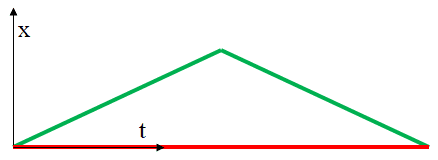

I read through "A Geometrical View of Time Dilation and the Twin Paradox" from the FAQ but I still have questions.
I feel a little guilty writing this post because I'm sure there are people here who are tired of answering questions about the twin paradox, hence the FAQ post on the subject, but there's something which is still nagging me. First I have a question about the FAQ post itself. Toward the bottom of the page, the equation
245048
is written. There was a similar equation,
245056
, in the prelude at the top. I'm confused by the left side of these equations. My understanding of what was meant by ##\tau^{'}_1## and ##l^{'}_1## was that they were the lengths of the red line segments in the diagrams, so the effect of putting them over 2 would be to cut them in half. But this is precisely what was said to be an error. That is, ##\tau^{'}_1/2## and ##l^{'}_1/2## are not half the length of the line segments. Could someone straighten this out for me?
Okay, now for what's really nagging me. I feel like this really gets to the heart of why schmucks like me can't wrap our heads around the paradox (or maybe it's just me). Despite the confusion I described above, I think the FAQ post did a pretty good job of shedding light on the issue. We start with a set of perpendicular axes and calculate the proper times for the red (stays on Earth) observer and green (flies off and comes back) observer. We see that the proper time for the red guy is greater than the proper time for the green guy. Then we switch to oblique axes, we work through it again, and voila! The proper time of the red guy is still bigger. I know I should be satisfied by this but there's something that still troubles me and, like I said, I think it gets to the heart of what's so unsettling about the paradox. Why is the green guy always the bent one? Here's what the basic diagram looked like in the FAQ...
245047
Now I know I must be wrong somewhere, but it really really feels like we ought to be able to draw a diagram like this...
245055
In this case, the green guy looks like he's staying put while the red guy moves first in the negative direction and then back. It seems like we should be able to go through all the same steps that were explained in the FAQ and discover that this time the green guy's proper time is the greater one whether we use perpendicular or oblique axes. Something tells me I can't be the only one who is thinking along these lines so if anyone can explain where the error in my reasoning is, you'd not only be helping me out but maybe others as well. Perhaps an explanation could be added to the FAQ.

The situation of the twins is not symmetric. Even without any external reference, the traveling twin knows that he is following an accelerated path when he reverses direction. The only unaccelerated paths in his reference frame is a straight line (geodesic) in his spacetime. When he deviates from that, he is accelerating. I think that a good video is Twin Paradox in General Relativity.
It does seem that way, and that’s why it’s called the twin paradox - you’ve just put your finger on the argument that makes it seem paradoxical. However, there is a resolution: the formula that says the proper time between two events is ##\tau=\sqrt{\Delta{t}^2-\Delta{x}^2}## is only correct if the x and t coordinates are those of an inertial frame. The frame in which the green line is straight is not inertial, so you can’t use that formula.
On a plane in space, which is Euclidean, the shortest distance between two points is a straight line. Any path other than a straight line will be a longer path. It doesn't matter what sort of diagram you draw, this is a physical fact about the geometry of the plane.
The geometry of space-time is less familiar. It goes by the name of "Lorentzian", but I don't think knowing the word explains much. The property it has though, is that the closest equivalent to a straight line is the worldline of an inertial observer.
The worldline of an observer who turns around is simply not inertial.
The analogy between the twin paradox and the straight line on the plane isn't quite perfect. Do to what's basically a sign difference, the path of an inertial observer in the geoemtry of special relativity has the longest elapsed time. Any other possible path that an observer could take will have a shorter elapsed time. This is a basic property of an inertial observer.
The obsever, or twin, who turns around simply isn't inertial, and that's why the argument can't be reversed.
In relativity the amount of bending of a worldline is measured by an accelerometer. If the accelerometer reads 0 then the worldline is straight (the technical term is “geodesic”). So the green guy’s line is bent because his accelerometer is the one that records a bend. The time of the accelerometer reading determines the time of the bend and the magnitude and direction of the reading determine the sharpness and direction of the bend.
The accelerometer readings are directly related to the previous posters discussions about inertial and non-inertial.

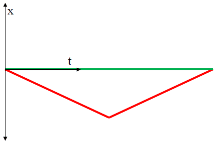

The accelerometer readings don’t support that drawing. In fact, they directly contradict it.

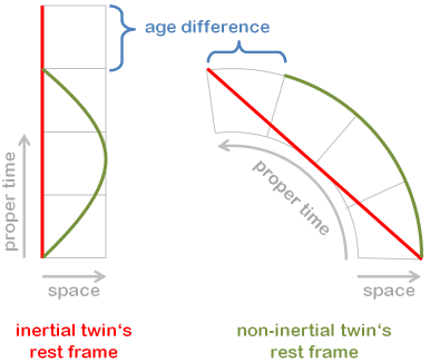

If you want to see the age difference directly, you can use a space-propertime diagram. Here the length of each path represent the coordinate time t, so both paths have the same length, but they end up at different proper times (age differently). You also have to account for the acceleration of the travelers frame, which is simplest assuming constant acceleration, which results in curvlinear coordinates:
Here is a comparison of Minkowski and Epstein diagrams for the 3 inertial frames of the twins (traveler has constant speed with instantaneous turn around): http://www.adamtoons.de/physics/twins.html

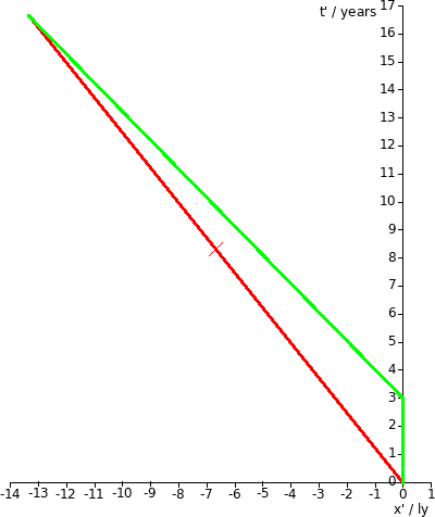

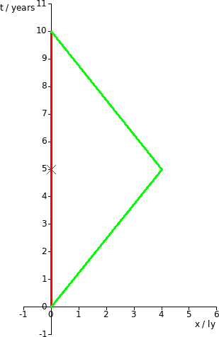

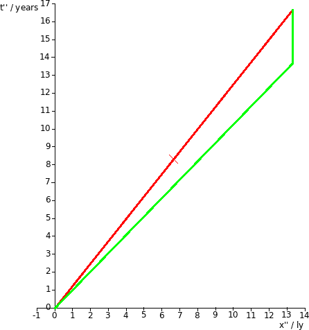

You can try doing that, but the relativity of simultaneity bites you. Here are three Minkowski diagrams showing the same scenario. I've used your colour convention, and the only thing I've done is add a red cross marking a party the red guy holds at the midpoint of the experiment. The first diagram is in the frame where the red guy is at rest:
The next is in the frame where the green guy is at rest on the outbound leg:
The final one is in the frame where the green guy is at rest on the inbound leg:
Now let's try to construct your diagram, by snipping the top off the second diagram and the bottom off the third diagram, keeping only the parts where the green guy is at rest in each frame. That looks like this:
245073
That's pretty much what you drew (I've done a literal cut-and-paste, which is why bits of axes appear) - but where has the red guy's party gone? The problem is that in the outbound frame it happens after turnover, and in the inbound frame it happens before turnover. The two frames have different ideas of what "at the same time as turnover" means (this is the relativity of simultaneity), and the party gets lost in the cracks. So that means that this diagram is not an accurate representation of reality.
You can, of course, construct a more complicated diagram that shows the green guy as "at rest", but the red guy's path does not look like you have drawn it. Figure 9 in https://arxiv.org/abs/gr-qc/0104077 shows one way of doing it - the dashed red line ("Alex") corresponds to our red guy and the solid red line ("Barbara") to the green guy.
