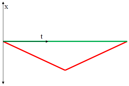

  • #31
SamRoss said:
Do you understand that if I give you a blank piece of paper then you have the freedom to choose which lines will be bent and which won't?
I can draw anything at all on a piece of paper. But if I'm hoping to depict a twin paradox scenario, the line denoting the traveller needs to have a corner. As Orodruin says, it doesn't matter why it has a corner because the interesting result depends only on the fact that the line is bent, not why it bends.
You can subsequently deform the page to hide the curve of the line if you wish, but you also distort the worldlines of clocks and rulers used to measure things, and the overall result is unchanged.

  • #42
SamRoss said:
I understand that perfectly well. Do you understand that if I give you a blank piece of paper then you have the freedom to choose which lines will be bent and which won't?
No, you don't have that freedom. A blank piece of paper has an associated "metric", which determines the distance between nearby points. This determines the length for any curve on the paper. For Euclidean geometry (which applies to a piece of paper), a straight line between two points on the paper is the curve with the shortest length connecting those points.

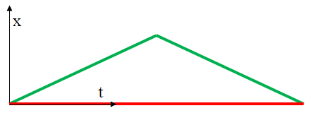

I think that is a valid point. There is always a reason for the bend. Possible reasons include:
1) some real force, like a rocket engine
2) stitching together two inertial observers that are not mutually at rest
3) curved spacetime
The bend is not where the extra time is "stored" or "created", but it does distinguish the two paths. With that distinction in mind you can then unambiguously examine the length of the respective paths to determine the time difference.

  • #55
PeterDonis said:
The only general rule is that specifying the lengths of the lines is what takes the freedom away.
Are we doing pure math or physics? How can we specify the lengths of the lines without looking at what's actually going on in the situation? How can we justify making one line longer or shorter than the other unless there is some physical distinction between the two observers in the real world?
  • #56
The different lengths of the lines correspond to the different elapsed times on the observers' clocks. That's a physical distinction. And it's the only physical distinction that will always be there in any "twin paradox" situation and will always correspond to the thing that defines the kind of situation you are interested in (different elapsed times for the twins between the same two points in spacetime). Sure, there will be other physical distinctions between the twins, but none of them correspond to a general rule that let's you predict which one will have more elapsed time.

  • #58
PeterDonis said:
There is no general rule that says "the one under the influence of the force has the shorter worldline".
But there is a specific rule for flat spacetime that says that the one that is not under the influence of a force has the longer worldline.
  • #59
In the special case where there is one who is not under the influence of a force, yes. But that's a special case.
