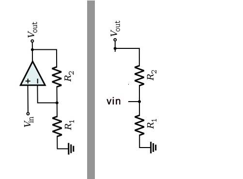

I have attached image. Thanks in advance.

I think I got it . Here vin is the function of the vout. The section of the image containing the R1,R2 and Vout and vin can be regarded as voltage divider apparatus and vin is fed at
input . I have uploaded the pic (my understanding).

I think a simple answer is that the resistor is used to tune the gain. Also when an Opamp circuit has negative feedback the negative terminal tracks the positive terminal.
Eg since in your original circuit the positive terminal grounded and there is negative feedback; you negative terminal appears to be grounded.
Without the resistor before the negative terminal, you would be shorting your input voltage and no current would flow into your feedback resistor ,thus, no amplification. :-)
Op Amps have very high voltage gain (you can often treat it as infinite).
The feedback resistor allows current to flow from output to (-) input. Whatever the input voltage is, relative to the 0V point, the output voltage 'goes the other way', about the zero voltage of the input until the feedback current cancels the current flowing through R1. This form of feedback has the action of maintaining the (-) input terminal at (or very very near)0V. It's called a virtual Earth circuit and its 'closed loop' gain is given by -R2/R1 (the negative is there because it 'inverts' the signal). It's a very neat idea because the circuit gain is pretty well independent of the gain of the actual op amp (assuming it's high enough / very high). It's very bad design practice to have circuit elements with an undefined gain so this is a useful configuration. The more feedback, the lower the gain but the more linear the amplifier is - you take your pick.

Thanks for the reply people. I have made following conclusion from your quotes
1) The R1 and R2 network which is voltage divider basically fed into the negative terminal will
have negative feedback- Vgain= A( V+ - V-) , (because V- is subtracted from V+ , overall it has effect of decreasing the gain)
2) It tries to maintain the neagtive terminal at 0V .
3) Thus making the gain independent of A and making it dependent of R1 and R2.
I must say that I am thoroughly confused after reading this thread. Although this discussion is very conceptual. I think that is you did the math, you would find the reason to have the R2 resistor.
The open-loop gain of an op amp (OA) is infinite (~100,000 V/V).
ONE of the configurations of an op amp is the inverting op-amp, the one that is first pictured. Th R2 resistor provides a negative feedback to the op amp and brings the gain down to a much more manageable -R2/R1.
Note : We use 0 to represent the voltage at the negative input terminal because as the gain approaches 0, the voltage between the terminals approaches zero (virtual ground).
--> i1 = Vi-0/R1 = Vi/R1
--> Vo = 0 - i1R2
--> Vo = -(Vi*R2)/R1
-->Vo/Vi = -R2/R1

I wouldn't disagree too much with that except with the word "tries". OK in casual conversation but, of course, no circuit actually "tries" to do anything (far too dumb). Substitute a phrase such as "has the effect of".
Feedback is a 'loop' and cause-and-effect are inter related. If you think in terms of "what happens if the output voltage were to change a bit?" and then say what will happen to the current flowing into the (-) input terminal and then how that would affect the voltage at the output terminal i.e. pulling it back to its original value, that could be a way of getting to grips. Personally, I am a great believer in following the maths from an initial mathematical model of the circuit.
