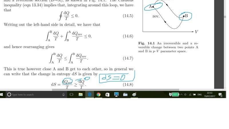

it seems it is not reasonable
Sorry
it said that delta S>=0
in an isolated system. i know why they put " = " sign, but i don't know why it is still possible that dS>0 in an isolated systembecause in an isolated system,it is said that dQ=0 (because no heat transfer between the system and the environment?)
by the same logic,dQrev is also 0 in this case
So there should not have " > " sign in an isolated system?
any entropy change in any isolated system is 0 because dQrev is 0
so delat S=0 in an isolated system but not deltaS>=0?
what is the difference between dQrev and dQirrev ?

The classical example is that of stirring a viscous fluid with a paddle. Even if the system is thermally isolated, the work done on the system (stirring of the paddle) will be converted into internal energy. Basically, the friction will heat up the system (also no heat is transferred to the system by the boundaries!) . So its entropy will increase. As friction is dependent on velocity, this mechanism is absent when you only allow for reversible changes of the system. So if you want to bring the system from the same initial to the same final state, you have to provide the system with external heat, i.e. this process cannot be done both reversibly and adiabatically.
but why the dQ (not reversible one) is 0 in such case?
If you do it, say, in a Dewar, where should the heat come from?

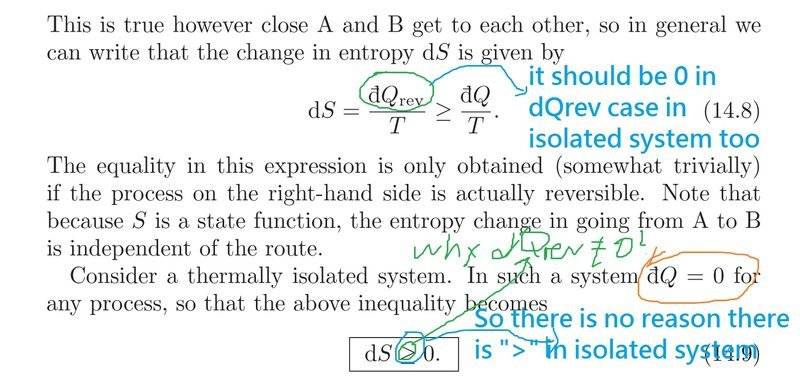

In an isolated system, dQrev is 0. The only way to calculate the entropy change using dQrev is to consider a reversible process instead, which can't be isolated.
I choose one where W=0, i.e. all the change of U is due to Qrev, which must equal Wadia in the irreversible,adiabatic case.

do u agree that the definition of entropy change in general is Sb-Sa=intregrel(a to b) dQv(rev)/T (where it is >= intregrel (a to b) dQ(irrev)/T)
b and a represents any two points at any path of states.

Entropy is a state variable. That means that its value only depends on the actual equilibrium values of p, V, T ... but not on how you get there. However, you can only calculate the entropy change when going from state A to B, using your formula for a reversible path, not for an irreversible one.

If you consider only adiabatic paths, in general there is no reversible path joining A and B, so you can't determine Qrev.

You need a non-adiabatic processes to determine S. You simply can't determine the change of S as long as you only consider adiabatic processes.

Depending on the initial state immediately after isolation, even in isolated systems "internal things" can happen between the various parts of the system, e. g., reactions between components, redistribution of components by means of diffusion, phase transition etc., until the overall system has attained its absolute thermodynamic equilibrium state. That’s the general meaning of ΔSsystem >= 0 for isolated systems.
Another example is free expansion of a gas: you have two cylinders (thermally isolated), one filled with gas, the other vacuum. You suddenly puncture the membrane between the two cylinders. If the gas is ideal, p*V doesn't change and so doesn't T. Neither does internal energy. Nevertheless entropy increases.
To calculate the entropy change you can again consider a reversible process, this time without thermal insulation, where the gas is slowly brought from V1 to V2 at constant T. As U is a state variable and didn't change in the adiabatic process, Qrev must equal -W in the new process.

In an isolated system dQ = 0 because no energy is transferred between the system and the environment. Whatever happens inside an isolated system results in an increase of the system's entropy.

Do you know how to determine the change in entropy of an isolated system that has experienced an irreversible change?
Are you aware that, in determining the change in entropy for an isolated system that has experienced an irreversible process, the reversible path you choose (to evaluate the integral of ##dS=dQ_{rev}/T##) does not have to bear any resemblance whatsoever to the actual path followed by the irreversible process (as long as it passes through the same two end states), and this includes paths for which the system is not isolated. In fact, for any reversible path between these same two end states, ##dQ_{rev}## is not zero. Here is a link that gives a recipe for determining the entropy change for an irreversible process, and includes examples applied to two isolated systems: https://www.physicsforums.com/insights/grandpa-chets-entropy-recipe/

why!? if dQrev doesn't actually exist in the process, why we can still use this "dQrev" to calculate the entropy.
then where is this dQrev coming from
dQrev is defined as the heat transfer between the system and the environment in the reversible process
the entropy should be zero?
because there is no dQrev transfer in such process?
the adiabatic process is not the free expansion and it is non isolated, and it is totally different system.
i agree the Qrev is increasing in the isothermal/adiabatic process.
but there is no heat transfer between outside and the system in free expansion.that means the dQrev is actually zero.
and dQrev doesn't related to the internal change of the heat(even the something can change inside the free expansion) but it just count the reverible path between (1)the system and the environment.
if the reversible path doesn't exist in free expansion, how comes there is dQrev change?
because there is no such reversible path for dQrev to transfer
For an isolated system that has experienced an irreversible process, it is impossible to get from the initial state to the final state using a reversible process path, without also exchanging heat with the greater surroundings. When we talk about dQrev, what we really mean that we are setting up an alternate process that follows a reversible path between the same pair of end states. So yes, dQrev doesn't exist for the actual process, only for its two end states. This is how we determine the entropy change between the two states.
but in some process, dQ should be less than dS T
can we use dU=ds T -p dv this law in such irreversible path
when dQ=/ ds T, then something will change here
i know this formula can be used in such case
but i get confused here
why!? thank
why!? thank
For a process taking place in an isolated system, ##\Delta S## cannot be less than zero. In a closed system where external work is done and/or heat is transferred out of the system, ##\Delta S## can be negative. But, for a closed system, irrespective of whether the process is reversible or irreversible and whether external work and/or heat are exchanged with the surroundings, the following inequality must always be satisfied: $$\Delta S\geq \int{\frac{dQ}{T_{int}}}$$ where ##T_{int}## is the temperature at the interface between the system and the surroundings where the heat transfer is occurring. For an isolated system or an adiabatic closed system, this reduces to ##\Delta S \geq 0##. The equal sign in these equations applies to a reversible path and the greater than sign applies to an irreversible path.
