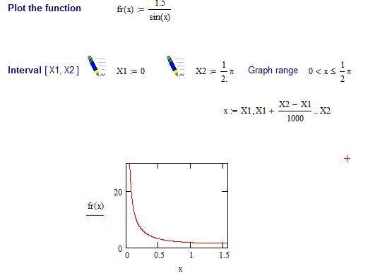

Ok, i need to explain why this function has an inverse function. fr^-1
[math]fr(x) = 1.5/sinx[/math]
and state its image set & domain.
Is that (0,1/2Pi]
Thanks :)
You realize that 1.5/sin(x) = 1.5csc(x), right?
On what interval(s) is 1.5 csc(x) one-to-one? There are a bunch, so pick one. If you haven't already graphed y = 1.5 csc(x), you should do that now, since it will give you a good start on determining domain and range for the inverse.
here we are plotted:
so how do we get the image set and domain

how does this explain that is has an inverse function
You should increase the size of the interval to, say, -pi to pi. You're getting only a small part of the graph of y = 1.5 cscx.
When you find an interval for which the graph is one-to-one, then the domain for your inverse will be the range of y = 1.5 csc x, and the range for the inverse will be the domain for y = 1.5 csc x.

ok Thanks - so how do i go about do that? basically from my attachment, i need to explain why fr has fr^-1, stating the domain and image set a hand would be great with it please

i hear what you're saying bud, but any advice how to take that further? I don't have a clue :(
You have a graph of y = 1.5 csc x. See post #5 and what I said about using a larger interval. Can you look at a graph and tell whether a function is one-to-one, either overall or over some part of its domain?
You were told in your problem that the domain of fr is (0, \pi/2]. Do you see why 0 is not included? For x arbitrarily close to 0, fr(x) is arbitrarily large. What is fr(\pi/2)? What is the range of fr?

The principal domain of fr(x) = 1.5*csc(x) is [-pi/2, 0) U (0, pi/2]. The range of this function is (-infinity, -1.5) U (1.5, infinity). In the original post of this thread, you guessed that the domain of fr was (0, pi/2], but the domain is actually quite a bit larger.
so do we make it?
for the inverse the image set (range)
(0,1/2pi]
for the domain
(1.5, infinity)
Yes, but those domain/range sets are only half of the story. The inverse function is defined at, for example, -2.
Did you ever get a better graph of y = 1.5csc(x)? The one you had in post #3 was too limited.
