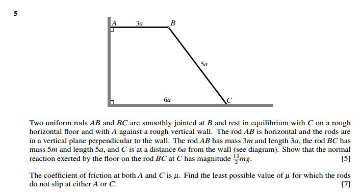

Will there be a reaction at the hinge B in this question?
6 replies · 2K views
Asad Raza
81
I have solved this question by completely disregarding the reaction at the hinge B. And surprisingly, answer turns out to be correct. Why is that so?
Half the weight of AB is on B (AB doesn't rotate or move) and that gives you the ##13\over2##.
For the second part I'm too lazy to work it out (you did that already); if you post your work, I (or someone else) may comment (e.g: "it doesn't matter" or "it's a numerical coincidence") :smile:
How do we know that half of AB's weight is on B?
You have 6 scalar unknowns: two components of each reaction force at the points A,B,C. You also have three equations of statics for each rod. I wish you good luck
But Reaction at B isn't playing a role. Just explain it to me that whether is that a coincidence or there's some solid logic behind?
How can I explain if you already know what plays role here and what does not? :)
