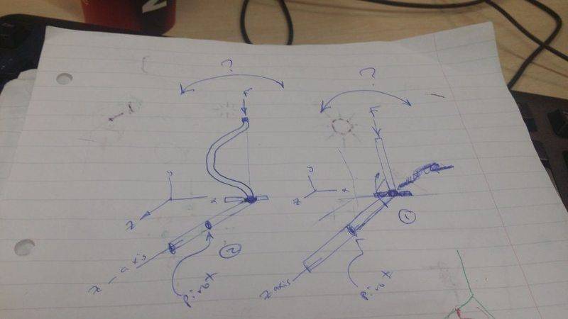

Handwritten sketch of two rod setups with a downward force F, each with coordinate axes x, y, z and a pivot marked, plus question marks above showing rotation arrows.
Hello people,
I know it seems like a silly question. In case 1, its clear that no rotation will occur around z axis. Anyhow, case number 2 is confusing me; I can't decide clearly if a rotation will occur since a moment should be generated around z axis, but in the same time, the line of the acting force is perpendicular on the pivot !
what do you think please, will it rotate in case 2 ?

any of the two structures consists of beams.
The structure looks like the English letter "L", where in the second case, the beam in y-axis has a bucking,
in the second case, rotation means that the beam in Y axis, which is in XY plan, will rotate to the x axis.

Kindly, find this sketch.
the statement is about to answer whether the curved beam will rotate around z axis or not, at the current position, and from the steady state status, due to the applied load>

I would call this case 3, to me it looks different from the others
I take it the left-handed coordinate system is accidental -- the axis that's pointing to the right is the z axis ( -- although 'z' ?)
And I assume the 'triangle' beam - beam - curved beam can only rotate around this z-axis, and that the arc with two arrows is in the xy plane.
The perpendicular distance from the line of action is zero: the line of action goes through the candidate rotation axis.
So the torque is zero and no rotation will occur.
But it's an unstable equilbrium ...

The thing which is confusing me, that this load will be analysed like in the photo, and thus a torque should be generated..
So, is there any physical way that can help to overcome this anomaly position ?

If ##\vec F## is in the yz-plane, there can't be a net component pointing outside that plane. Your sketch suggests ##F_z## in the yz-plane and ##F_1## along the curvature or something ?

Is there is any way to to overcome this anomaly situation, so we can make the curved beam rotates. I said that in the meaning of modifying the curved beam design somehow in order to divert the direction of the applied force and then to create a torque that able to create rotation ?
  • So far we've ignored the weight of the curved beam. That alone will make it rotate anti-clockwise.
  • Even if the curved beam has weight 0, it still is an unstable equilibrium, so in reality it will rotate, either clockwise or anti-clockwise.
So, this may happen while the exerted force is existing in this position. right ? :)
