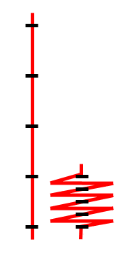

You could attach the wires so that they "feather" or "accordian" like a dropped mainsail on a sailboat. (See attached)

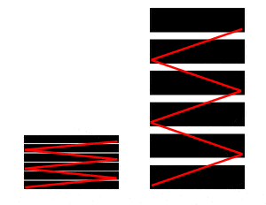

Better yet, just string the wire lengthwise on your cages. This will use more wire but will create less bending tension of the cables. Also, it doesn;t use any fancy widgets or attachments that could fail.
