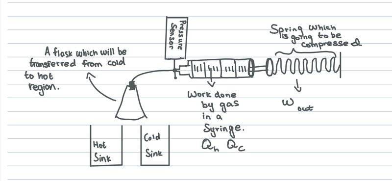

I have been looking at the heat engine concepts, and i'm a little confused. I have a experimental set-up which has a hot and cold sink, and a syringe where the gas inside expands and compresses when i switch between the sinks, and during the gas expansion, the syringe compresses a spring which compresses a spring. But, in this experiment, only understand that the isothermal processes takes place but how can i include the adiabatic processes so that it actually works like an actual heat engine.
Please, i need help
Hello sir,
Thank you for your reply. I have attached the diagram below. Hope you could help me with this.
  • Hand-drawn schematic of a heat engine: a flask moved between a hot sink and a cold sink, connected by a tube to a pressure sensor and a syringe, which drives a spring labelled as compressed; labels read Work done by gas in a syringe, Qh, Qc and Wout.
The setup as you have it is not going to do any work net work. All it is going to do is compress the spring and then release the compression.

Thank you for your reply again.
But is it possible that i can use this experimental set-up to calculate the mechanical efficiency of a heat engine. I think it is possible because i can calculate Qh, by using the formula for isothermal expansion and i can calculate Wext using the work done by the compression of the spring, which will allow me to calculate the mechanical efficiency of the engine. Is this possible?
If not is there any ways i can make this experimental set-up better. I really appreciate your help.
I think that various practical realities will make your approach impractical. Try searching heat engine cycle diagram, and study some diagrams. Consider the assumptions behind those diagrams - friction, heat loss, flow loss, and more, are all assumed to have no effect on the analysis. That is why a real heat engine always has efficiency much lower than the theoretical efficiency. Then compare the losses of a real heat engine to your simplified model. Keep in mind that real heat engines do not operate on perfect isothermal or adiabatic processes, but somewhere in between. The difference in losses between a real heat engine and your model will be very large, so large that your measurements will not be useful in analyzing a real heat engine.
If you search Stirling engine kit, you will find many small, low cost heat engine kits. You would be better off to get one of these kits and analyze it. If you merely measure the hot and cold side temperatures, heat flow into the hot side, and power output, you will learn far more than you will learn from your simplified model.

Yes, i understand what you're trying to explain here. But the aim of my research is "What effect does the temperature difference between the hot source and the cold sink have on the mechanical efficiency of a heat engine?" and i just want to mainly to use this set-up to understand how a heat engine works. Therefore, i can understand there are assumptions, but is there any way, where i can improve this experimental set-up to investigate about the aim of the research.
I have also looked at many PV diagrams for the processes of a heat engine cycle but in my experiment, i could see any clear adiabatic expansion or compression, but there was clear isothermal expansion, Qh and compression Qc, which i could use to calculate with the formulas. Even though, i do not get accurate results, i can evaluate all this in my evaluation. But, i just want to make sure, if this is the way a heat engine works.

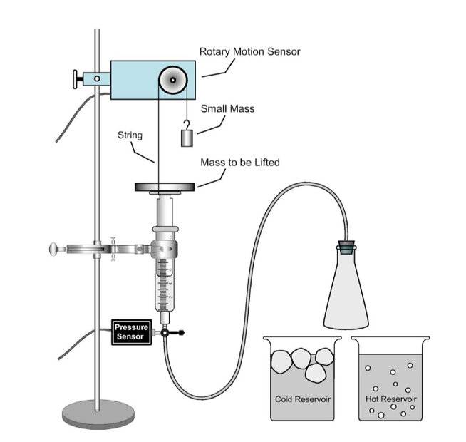

I would change the orientation of the cylinder to vertical, and replace the spring with pebbles that I could add or remove from the piston at various elevations.
Yes, i tried this set-up before coming up with this. It didn’t seem to work because the syringe was a 100cc one and my school doesn’t have 10cc one which is suitable for this experiment. This didn’t make the air to expand in the syringe due it’s low pressure and it doesn’t have the power to lift the piston. That’s the reason why i switched to this set-up. I have attached the experimental set up i used below.
I hope you can give me a advice to continue with this experiment.
  • Diagram of a lab apparatus: a syringe with a piston holds a mass to be lifted via string over a rotary motion sensor pulley with a small mass hanging. A pressure sensor is on the syringe, tubing runs from it to a flask, and the flask-to-syringe line dips into a cold reservoir and a hot reservoir.

Calculate the amount of force that your range of temperatures can apply to the cylinder (syringe). Then measure the friction in the system by disconnecting the tube from the syringe. Add mass to the "small mass" until the syringe slowly moves one way, then remove mass until the syringe slowly moves the other way. The difference between the mass to move one way and the mass to move the other is the total friction of the syringe/motion sensor/pulley system.
With regards to the first experimental set-up, so can i continue to with that set-up but just remove the spring and add a force meter, to detect the force by the expansion of the syringe, and does that force show the work done by the heat engine? If so, how can i calculate Qh of that set-up and link into thermodynamic processes. I'm confused, but I'm interested to understand more and to conduct my experiment which is important.
I have a question, if i followed this set-up. Can i relate to processes of a real-life heat engine such as a stirling engine or which is the most suitable heat engine to relate it to.
