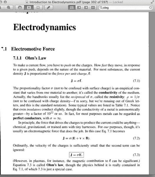

i was just reading the book Introduction to electrodynamics by David Griffiths they say that the force that is responsible for the flow of current inside a conductor is an electromagnetic force that does the job ( and they take the electric field)
and they say for the EMF the force inside a battery for example is the opposite of the Electric field so outside the battery the electric field is moving the electrons so how come the potential difference across a resistor for example is the work against the electric field?
The upshot of all this is that there are really two forces involved in driving current around a circuit: the source, fs, which is ordinarily confined to one portion of the loop (a battery, say), and the electrostatic force, which serves to smooth out the flow and communicate the influence of the source to distant parts of the circuit:
f=fs+E. (7.8)
so ok the emf does work against the electric field but outside like the resistor the potential difference is not the work done against the electric field no?
PS: the quote is from the book
we can say outside the EMF the force on the electrons is (the negative charge of the electron)* Electric Field so that's why it's the work done against the electric field?(because this force is opposite to the electric field)??
