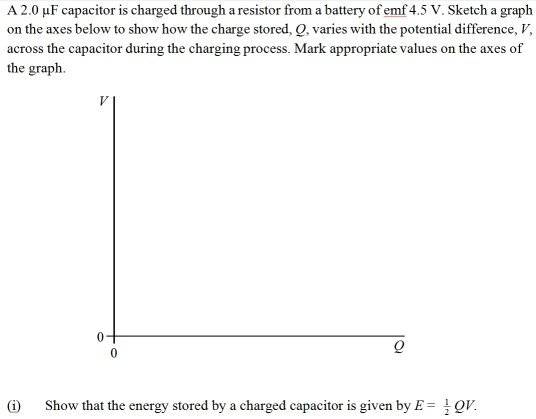

Empty axes for a graph of potential difference V against charge stored Q for a capacitor, with V on the vertical axis and Q on the horizontal axis, both starting at the origin.
Area of a triangle is 0.5 × b × h
ΔW=VΔQ
I drew a straight line graph from the origin with end point 4.5V 9.0 microF
energy is a work done = .5QV
There is a mark in the mark scheme for ΔW=VΔQ explained.
What do you think I need to say for this mark?
any help gratefully received
Your physics textbook, and perhaps your class lecture notes, should have an explanation of electric potential and how it relates to charge as well as work or energy. I would take a look at that.

I have just read in my notes that the energy stored in the capacitor is equal to the work done to force the extra charge onto the plates.
So ΔE=VΔQ
So V is changing and I guess if we make the increments very small in Q then the areas of each strip under the line add up to the total area under the triangle with base Q and Height V.
