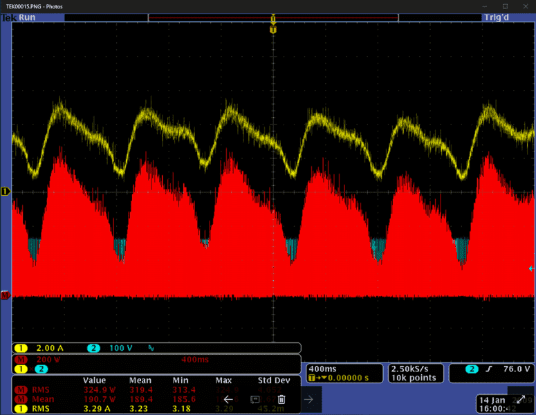

The Yellow waveform is the brushed DC motor current, Blue (which is kind of obscured in the background) is the PWM'ed motor voltage and the Red is their product (power in Watts).View attachment 212748
The crucial parameter would the speed of the belt. If there is only negligible variation of belt speed, you can define an inertial frame where the support surface is at rest. Per Galilean Invariance this frame is equivalent to the rest frame of a hill incline (ignoring air drag). So there is no physical reason to walk differently and do different work, just psychological ones.

@Roger Chase Its really generous of you to go to the trouble to share that data. If you have a way to add the radial velocity of the motor shaft or the belt speed (they should be proportional I think so it doesn't matter much which you plot if one or the other is available) like @A.T. was saying, that would be interesting to look at.
If one can calibrate out the unloaded work a treadmill motor does and if the addition of a runner does not change the dynamic frictional losses in the system significantly, then a treadmill with instrumentation to record the motor currents / voltages should be able to report very precisely the effective work a runner is doing, similar to work computers on bicycles. I am curious to know if any treadmills do this, if happen to know. Not sure I can ask this on a runner forum without folks thinking I am asking about heart rate calorie burn computations.
