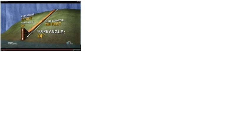

Hi all, I am currently working on a problem that i believe involves the work-kinetic energy theorem.
See the attachment and information below.
As shown in the figure, the geometry of the water slide used is 1m:
Slide length = 61,; Slope angle = 24; Ramp height = 3.66 m
Lubricant is used thus friction can be ignored. A man of 70kg slides from the start.
if the ramp angle is 30, find the magnitude and direction of the velocity of this man when he just flies away from the ram and the Horizontal distance that the man flies.
W=(1/2)mvf^(2) - (1/2)mvi^(2)
ok so first I find the force that is acting on the man as he starts sliding down the ramp. which comes out to be mgcos(24) = F
and i know the distance of the slide which is 200ft. And further we can say W=FD
so subbing values in and solving for vf I get 108.43 ft/s - this is the velocity when the man is at the the lowest point on the slide.
So then i find i repeat the process and find vf at the top of the ramp with an angle of 30. which gives me an answer of 102.08 ft/s.
There is no answer to this question so i have no idea if I'm right or not... any help would be greatly appreciated.
also to find the direction of this velocity can i assume at the instant he comes off the slide then the angle the slide makes to the horizontal is also the direction of his velocity?
Thank you again!

From your description, this is a conservation of energy problem but you don't need the work-energy theorem.
Start by describing the motion of the man in terms of the energy changes that occur in each stage.
OK - now I get it.
According to that diagram, the distance from the top of the slide to the point on the slope directly below the top of the ramp is 200 feet. The man does not go down a 200 foot slide and then up a ramp ... the ramp is part of the 200 feet and the overall length of the (colored brown) surface is going to be greater than 200 feet overall.
So the work-energy relation is not going to help you here - the force you worked out does not act for the entire 200 feet. *
My suggestion at post #3 stands: describe the motion in terms of energy transformations and use conservation of energy.
What sort of energy is lost going from the top of the slide to the top of the ramp?
What does it turn into?
[*] actually the arrow indicating the 200 foot length stops a bit short - yet goes past the curve to the bottom of the ramp ... so it is a little ambiguous. You could check what is intended here - but, if you use conservation of energy as suggested, it won't matter ;)

  • #35
Clever_name said:
Hi Simon! Try this link http://i49.tinypic.com/2vdh3yf.jpg to view a picture of the situation.
Did you know that you can display this image directly in your post?
