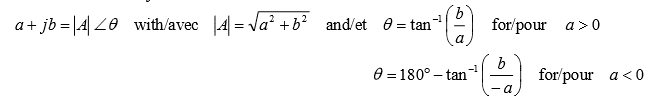

I am going over examples in my textbook and I came across this:
I don't understand how they converted 18.265 at angle of 39.9 to 14.02+j11.71
I know how to convert from the imaginary numbers into the angle form, usually I use:
Is there another equation when going in the other direction, or do I use the same ones. I will have two equations and two unknowns, one with tan and one with the square root? It seems a bit complicated and I feel like I am missing out on something, but I can't find it on my formula sheet or in my notes so I am a bit confused. Thanks !
It's akin to converting a vector in polar form to rectangular form. Use cos and sin to extract the real and imaginary component magnitudes.

Ok, Ok. I take the cos of the angle and multiply by the coefficient that becomes the real part, and then I take sin and multiply which is the imaginary part?

Yes. For phasors the exponential is implied, and we use the magnitude and phase angle for its shorthand notation.
The full form of the phasor is ##P = A e^{j(ω t + Φ)}##. The "ωt" part represents the rotating motion of the phasor. Splitting it: ##P = A e^{jωt} e^{j Φ}##. When the angular frequency ω is the same for all phasors in a system we just drop the rotating component from the notation and take it as implied. That leaves ##A e^{j Φ}## as the unique part of the phasor, and that can be represented by a complex number (rectangular form) or magnitude and angle (polar form) in phasor "shorthand".
Yes.
