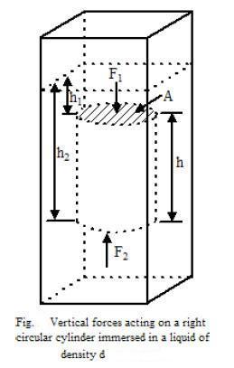

I was just reading about Archimedes principle. Suppose a cylindrical body (attached figure) is immersed in liquid of density d. if the weight of body outside liquid is Fout then can we say that this body will immerse in liquid when released to a depth where upward force F2 = Fout. And then it will stay there forever.

Assuming the object is fully submerged, the upward buoyant force on the object will equal F2 - F1. That has nothing directly to do with the weight of the object (what you are calling Fout).

I think I got it. The buoyant force B is that of liquid in upward direction. If we consider downward weight of fluid of same cylindrical shape Wfl then B = Wfl and this is in equilibrium and that piece of liquid will not move from its place in static rest of fluid. However if we replace the same cylindrical volume of fluid with some solid cylinder then now B may not equal to weight of cylinder and so it can move up or down. However if they are same then it will remain at that position. Now B is always same at all depths as B = F2-F1 would be same. So if we release object (for which B = Fout) at some deeper depth then it will remain there. If we release that object at some smaller depths again it will remain static there if fluid is not moving.

The weight of the object is irrelevant in calculating the buoyant force. The weight is certainly relevant when determining if the object floats, sinks, or remains in neutral buoyancy.
Only if the fluid (or object) were compressible would the buoyant force depend on depth.
