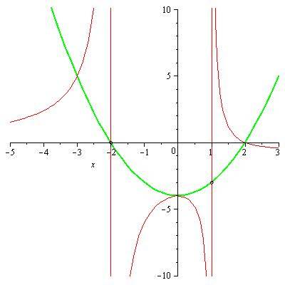

On The graph, the following information was given:
Point of discontinuity( -2,0) and (1,-3)
X intercept at ( 2,0)
Yintercept (0,-4)
This is what I had : (x+2)(x-2)(x-1)/ (x+2)(x-1)
But the answer is that u have to put (x+2)^2 in the numerator instead of what I had.
But I thought that the point of discontinuity was on that spot ( xintercept) and thus it would not be counted that there was an xintercept AND a point of discontinuity at that spot. Can someone explain this to me?

Hopefully you were asked to find a solution, not the solution, because there is more than one answer. Also the question doesn't specifically rule out vertical asymptotes for the discontinuities. Even if they are ruled out, there is still more than one answer. But to answer your question, it wouldn't matter whether there was ##\frac{(x+2)^2}{x+2}## or ##\frac{x+2}{x+2}##. They both have a removable discontinuity at ##(-2,0)##. That point is not on the graph in either case, so it is not an intercept.
[Edit, added]: Actually the seond one's removable discontinuity is at ##(-2,1)## which is likely why your teacher wanted the numerator factor squared.

Here's a picture of your graph after you square the ##x+2## giving$$
f(x) = \frac{(x+2)^2(x-2)(x-1)}{(x+2)(x-1)}$$That graph is the green parabola with the holes at ##(-2,0)## and ##(1,-3)##. The red graph is$$
g(x) = \frac{-4(x-2)}{(x-1)(x+2)}$$It has the same ##x=2## and ##y=-4## intercepts and is also discontinuous at ##x=-2## and ##x = 1## by virtue of having vertical asymptotes there.

The graph looks like the green one. So I guess the reason why it would be squared is only for the y intercept
No, it's to have an x-intercept at x=-2.

The main reason the x+2 is squared is to get the "intercept" at x=-2. Except that it isn't an intercept; it is a removable discontinuity. The fact that the y intercept is -4 just happens.
Personally, I think the teacher started with ##f(x) = x^2-4## and then threw in some factors to make the two holes in the graph. But the conditions ##f(0)=-4## and ##f(1)=-3## are redundant. You wouldn't normally expect a parabola to pass through two specified intercepts plus two more specified points.
Also my point in showing the two graphs is to show the solution isn't unique or, at the minimum, the problem is poorly thought out.
