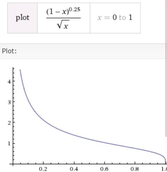

  • #40
TEFLing said:
Oh I understand now
dL/d(tau) = constant
If you ignore the surface luminosity as small compared to the core luminosity...
Then
L(r) = L0 (1 - (r/R))
T(r) ~ (1/r^0.5) (1 - (r/R))^0.25
trying to upload figure from Wolfram Alpha website
  • #41
Something isn't quite right there, outside the fusion zone it is L itself that is constant.
  • #42
L can increase linearly inwards, and still keep every shell in equilibrium
Shell two radiates two units of power outward and inwards (-4), but gets one from above and three from below (+4)
L increases inwards but the star is in equilibrium

There is indeed some latitude in what you do if you are not exactly solving the equations of stellar structure, giving the basic explanation for L a kind of subjective character. Personally, I'm not in favor of using the core and surface T as though they were the same thing, because they are set by very different physical processes. The core T is set by the need to self-regulate fusion to replace the heat that is diffusing out, and the surface T is set by the need for the blackbody emission at the surface to match that luminosity, so the former is fusion physics and the latter is Stefan-Boltzmann physics, and there is no reason the two should be the same or even proportional. So I wouldn't use L ~ R2 T4 for anything but a way to infer the surface T. Also, if you use diffusion physics to get L, you never need L ~ M2 / R3 Tn, you can just use L ~ R4 T4 / M from diffusion with constant opacity (or modify that for some other opacity like Kramers, but it won't be more accurate), and T ~ M/R from VT, and get L without even saying whether fusion is happening or not. However, if you want to get T in the core, and R, and then T at the surface, you would need to do what you are doing, since then you do need to know that fusion is happening.
The bottom line is, it is possible to get simple scaling relations to help understand, at a rough level of approximation, all the basic properties of a main-sequence star that is not completely convective and does not have strong radiative forces. These general scaling laws have been around for a long time, and there is really no excuse for any astronomy textbook to claim that high-mass main-sequence stars are more luminous because their stronger gravity compresses the core to higher pressure and temperature. None of the scaling laws have that character, it's really just completely wrong.
