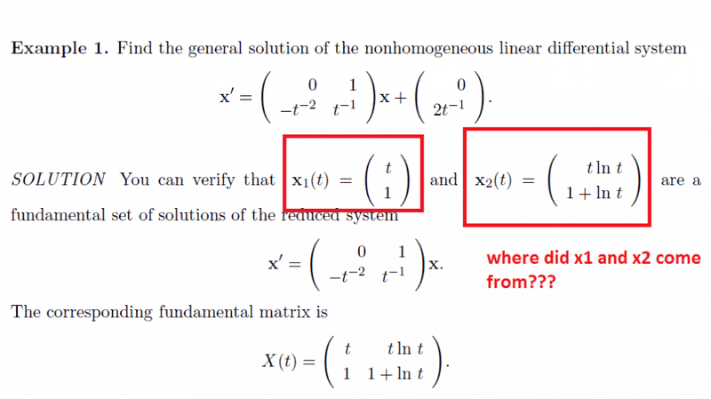

Find general solution of the given problem in the pic
All I need to know is where they found the fundamental set of solutions.
All I need to know is where they found the fundamental set of solutions. Please see pic. All I want to know is where did the x1 and x2 come from. If I have those then I can do the rest.
See attachment image.

There are a number of different ways to do a problem like that. Probably the simplest is:
Letting [tex]x= \begin{pmatrix}x_1(t) \\ x_2(t)\end{pmatrix}[/tex]
we can write the equation as
[tex]\begin{pmatrix}x_1' \\ x_2'\end{pmatrix}= \begin{pmatrix}0 & 1 \\ -t^{-2} & t^{-1}\end{pmatrix}\begin{pmatrix}x_1\\ x_2\end{pmatrix}+ \begin{pmatrix}0 \\ 2t^{-1}\end{pmatrix}[/tex]
[tex]\begin{pmatrix}x_1' \\ x_2'\end{pmatrix}= \begin{pmatrix}x_2 \\ -t^{-2}x_1+ t^{-1}x_2+ 2t^{-1}\end{pmatrix}[/tex]
which gives the two equations [itex]x_1'= x_2[/itex] and [itex]x_2'= -t^{-2}x_1+t^{-1}x_2+ 2t^{-1}[/itex].
To solve those equations, differentiate the first one a second time: [itex]x_1''= x_2'= -t^{-2}x_1+ t^{-1}x_2+ 2t^{-1}[/itex].
From the first of the two equations, [itex]x_2= x_1'[/itex] so we can write this equation as [itex]x_1''= -t^{-2}x_1+ t^{-1}x_1'+ 2t^{-1}[/itex] which is the single second order equation [itex]x_1''- t^{-1}x_1'+ t^{-2}x_1= 2t^{-1}[/itex].
Multiply by [itex]t^2[/itex] to get [itex]t^2x_1''- tx_1'+ x_1= 2t[/itex]. That is a "Cauchy type" or "equi-potential" equation (since each derivative is multiplied by t to the same power as the order of the derivative). The change of variable, u= ln(t), changes the equation to a corresponding "constant coefficients" equation, [itex]d^2x_1/du^2- 2 dx_1/du+ x_1= 2e^u[/itex].
Can you solve that equation?
Thank you so much! I solved the equation.
x(t)=c1t+c2tln(t)+t[ln(t)]^2
the matrix solution seems to be the wronstkian of the functions next to the c1 and c2, however the third term which doesn't have a constant I'm not sure what to do with it or if it has any significant importance.
I assume you mean that is the solution for the function I called "x1". You still need to find x2 in order to find the vector function solution. Remember that you are solving a "vector differential equation" so you need a function for both components.
T=As for "the third term which doesn't have a constant", the set of all solutions to a second order linear homogeneous differential equation, here [itex]t^2x_1''- tx_1'+ x_1= 0[/itex], form a two dimensional vector space. The two functions, t and t ln(t) are "basis vectors" for that linear space. Every solution can be written as a linear combination of them: c1t+ c2 t ln(t).
The set of all solutions to a linear non-homogeneous equation, [itex]t^2x_1''- tx_1+ x_1= 2t[/itex] form a "linear manifold". Where you can think of a linear vector space, geometrically, as a plane containing the origin so a "linear manifold" can be thought of as a line or plane that does NOT contain the origin. What we can do with such a set is imagine as using the plane through the origin parallel to that linear manifold. We can represent a point on that "manifold" as a vector in the "parallel" vector space plus a vector to that plane. The set of all points (here, functions) in that manifold can be represented as a general function in that parallel two dimensional space plus that one vector to the plane.
