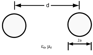

modmix
In case of a transmission line consisting of two wires in parallel (aka Balanced line) the characteristic impedance Z0 is given by this equation:
where l is half the distance between the wire centres, R is the wire radius and \mu, \epsilon are respectively the permeability and permittivity of the surrounding medium.
I have two questions I cannot answer myself:
  • what is the characteristic impedance in case of wires of different diameter ?
  • In case of a tube rather than a solid wire: does the characteristic impedance depend soley on the outer diameter or does the inner diameter play a role as well?
Thanks in advance for any hint.
Ulli

Thanks Dave for both, the welcome and your answer.
Nice to be back at what I did more than 30 years ago at university ,-)
I guess I wasn't precise enough - the page you pointed at talks about coax.
I'm looking for a formula to describe a Twin Line where the diameter '2a' of both wires is different ( eg. 0.8 mm and 2 mm).
from: Transmission Line Parameter Calculator
cheers
Ulli

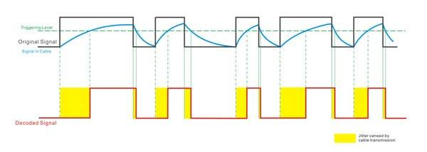

It is the outside diameter that matters with RF conductors. They are modeled as thin walled conductive cylinders. The current flows only in the surface. With a coaxial line the signal propagates through the dielectric between the outside of the inner and the inside of the outer conductors.
Audio quality is not degraded when transmitted over a digital link unless there are bit errors. That is better fixed by using a higher quality coaxial line rather than an exposed parallel line. The exposed parallel line will pick up external signals that will on occasion cause more significant bit errors than the original coaxial line. Parallel lines have less dielectric and so are characterised by significantly lower losses than coaxial cables, maybe your line is too long and you need a radio link.
A parallel transmission line in an audio environment will need to be twisted or it will generate EMI. When it is twisted it will need some dielectric insulation for support. That will again increase the dielectric losses. The distribution of the dielectric will defeat any simple Zo formula and so suggests the use of FEA.
The characteristic impedance of a transmission line, Zo = Sqrt(L/C); where L and C are the inductance and capacitance per unit length. So to calculate the impedance you must calculate the self and mutual inductance of the two parallel conductors along with their capacitance in the presence of a distribution of dielectric that distorts the electric field. Those are both very involved computations.
Now the problem is that you cannot make transmission lines with impedances below 200 ohms without significant capacitance which requires a dielectric. That results in losses which in turn increases the bit errors.

You must differentiate between the transmission of the bits and the initial “analogue to digital” and final “digital to analogue” conversion processes. The transmission will not degrade the audio if there are no bit errors over the link. That is a simple fact. There is jitter in every data stream but the D to A converter at the far end is being clocked with data at a much lower rate than the jitter. 32 bit serial data with 10% jitter is only 1/320 of the sample rate which is 640 times the highest frequency in the audio. If there is loss of audio quality it is because the converters are poorly designed.

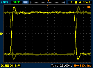

How do you know you “did” those characteristic impedances? Do you really have a time domain reflectometer? I expect you used insulation which has losses so limits the range, just like a coaxial line. Because your signal works once does not mean it will always work since interference is spasmodic, people walk around with mobile electronics. Coaxial lines are used to avoid interference.

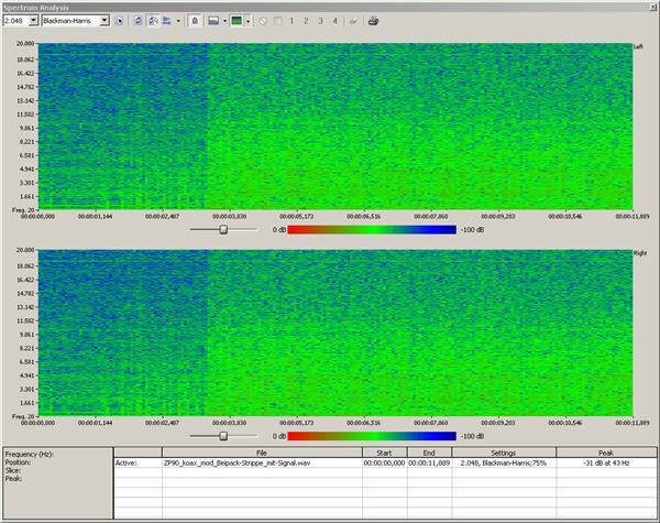

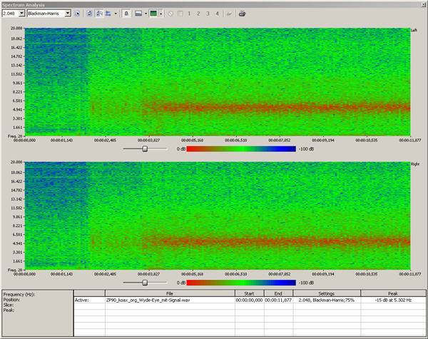

In a german forum Gert reported some measurements on how jitter depends on an SPDIF cable (the vco voltage at the receiver is recorded).
Apogee Big Ben als Jittermonitor
Welches Koaxkabel für S/PDIF? p.5 gives some spectrograms like this
The like to the recorded files doesn't work anymore.
Give me your email address in case you would like to get the files.​
If you agree, I'ld like to come back to the thread question (formular for Z0 of a lecher wire with wires with unequal diameter).
Thanks.
Yes. Sort of: an ATtiny13 on a LT Demo Circuit board gives pulses watched with a 400 MHz scope:

solved
see Bild 4a and equation (7) in mgk1.pdf.
cheers
Ulli

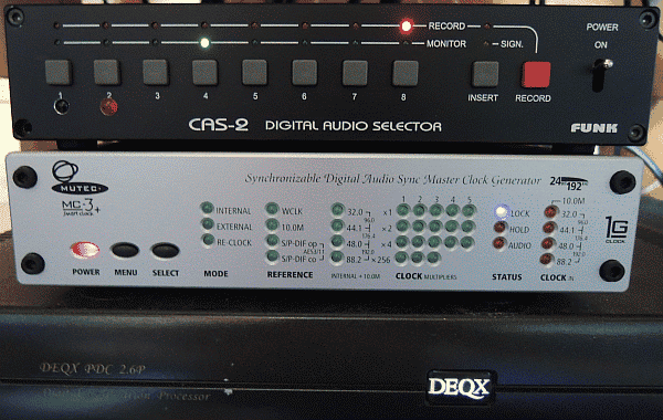

We did a check with a β-version of the Mutec MC-3+ smart clock used as a re-clocker. I had two different verisions at that time. I simply wanted to get a second opinion on that gear. In a first run, the result was reverse to mine. Then we flipped the digital cables (the said better cable now between re-clocker and dac). Now the result was 'correct' ,-)
The friend left the room. I stayed for further listening.
As it wasn't the best heard configuration, I stood up and changed to the best configuration. Well, it wasn't as good, as I've heard this before - may be I'm simply tiered, I thought.
The friend came back and immediately started complaining loudly about the bad sound. After a while, I asked him: "Do you know that you are telling me, that the so far best heard configuration doesn't play well?" "No! that cannot be the case!". He went to see what configuration we were listenig to. Yes, seemed to be the best one. He went back for further listening. As he was still sure that that wasn't right, he went again to see what's going on. "What did you do?" he suddenly asked. "Nothing except for going back to the best configuration..." - "Hee, hee, you made a mistake! the digital cable is not connected in the right direction!"
After having changed that, sound was indeed better.
My friend didn't know that I had changed the setup.
I didn't know about the direction of the digital cable.
- blind enough?
I do stop here.

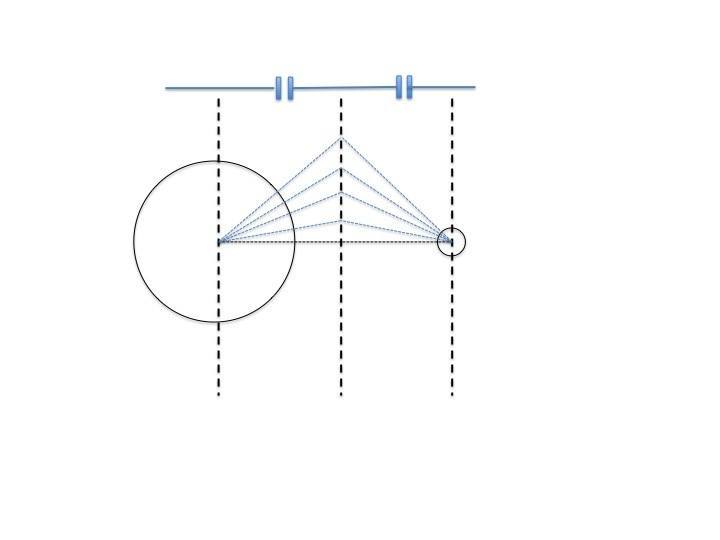

Here's a suggested way of getting what you want.
The answer you get should be somewhere between the Z0 for a pair of the thick and a pair of thin wires, as a check. Before you go to the trouble of all that follows, just find what it would be for equal diameters. If there's not much difference then it may well not be worth bothering. (How accurate can your match be and what is the impedance in the rest of the circuit? There will be an acceptable VSWR that isn't 1.000)
You need to know the C per unit length and the L per unit length:
(Z0 = √(L/C).
To find the C.
This is certainly going to be a pretty good approximation for finding the capacitance between the lines.
Treat the two lines separately and take a perpendicular line, half way between the two centres. This line will be a line of symmetry and the distance to use for your calculations- the fields (each wire on its own) would be shown by those radial lines. Of course, they will be curves when there are two lines but you can still expect symmetry (or at least near symmetry). The capacitance between the two lines will be the equivalent to two capacitances in series, each one, corresponding to the capacitance of one line and the plane of symmetry. You can google the formula for C of an unbalanced line.
To find the L, find the inductance of two parallel wires of a equal diameter and spacing (easily googled). Then take the mean for the two different diameters.

That's why you can't use an oscilloscope to what the signal eg for detecting impedance mismatch?
Randomly selected example of hi's and lo's:
