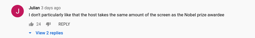

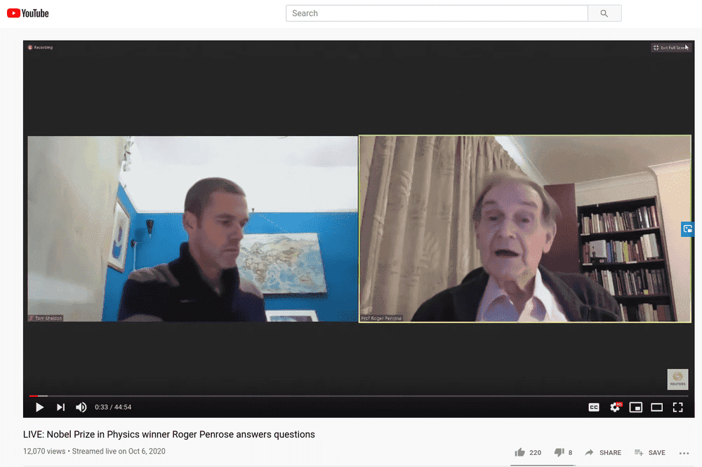

You may have watched this interview of Nobel prize winner, Roger Penrose.
Now with Zoom-Clude®, the amazing nobel prize winning Firefox extension, you can block out the left person on a video of a 2 person zoom meeting. The extensions works on both PF and YouTube. Different occlusion features coming soon!
Before:
After:
Follow this as a guide:
https://developer.mozilla.org/en-US/docs/Mozilla/Add-ons/WebExtensions/Your_first_WebExtension
But use these files (need to also download jquery and make an icon...)
