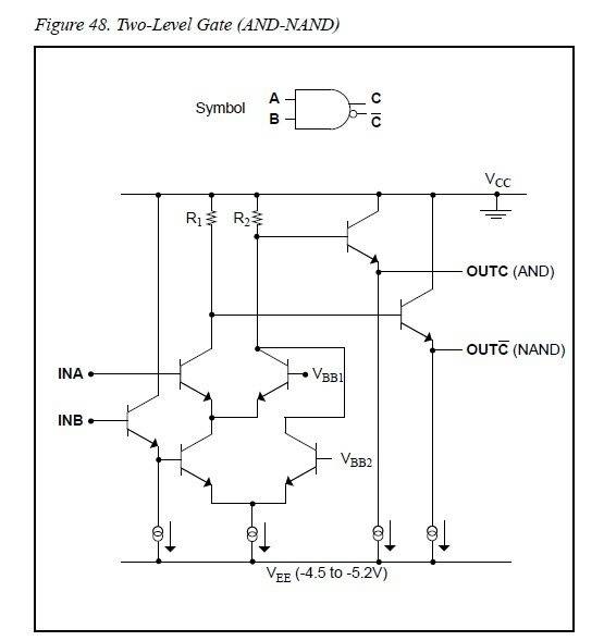

I need to simulate a AND/NAND gate with Emitter Coupled Logic. As I'm sure that most of you know, ECL is mostly used to make OR/NOR gates, so finding out how to make a NAND/AND gate is not as easy as it sounds.
I attached an image of a possible model that I found online. However, how do I know which values I should put in order to make the circuit work? How do I know which voltages should be in VBB1, VBB2, etc?
Thanks

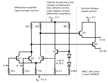

jean28 said:
That is for OR/NOR functions.
True, but it does show that VBB for Q3 is -1.29V, while VCC is -5.2V, the same as your AND / NAND circuit. In general, VBB is set to the middle of the .8 voltage difference beween a logic "0" and a logic "1". I found an ECL document that specifies the voltage range for VBB as well as the other voltage ranges:
https://smartech.gatech.edu/jspui/bitstream/1853/32110/1/PG_TR_050518_RJP.pdf
I think it will be slightly different for the NAND because if you follow the path from INB to VBB2 there is an aditional Vbe compared to a NOR. It goes...
INA - Vbe -Vbe +Vbe = VBB2
So set INA to mid way between logic 1 and 0 and you can calculate VBB2.
For INB it's..
INB - Vbe + Vbe = VBB1
Basically the principle is that of a differential amp/long tailed pair configured as a comparator (eg one input fixed voltage).
