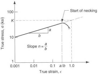

True Stress-Strain Curve on the Log Scale: Which portion is the plastic region?

My math is a little weak, so I'm having a hard time finding the elastic and plastic regions on this curve. Any further help will also be appreciated!
Remember Hooke's law. What comes first, elastic or plastic action, when stretching a specimen?
The elastic region comes first. But can you differentiate between the two in the figure?
Hooke's law says that in the elastic region, stress is proportional to strain.
In your graph you have a strainght line on a log log scale (not a linear scale) but the stress and strain are not proportional.
If your graph is drawn correctly, you can't find the elastic region because it isn't shown on the graph!
