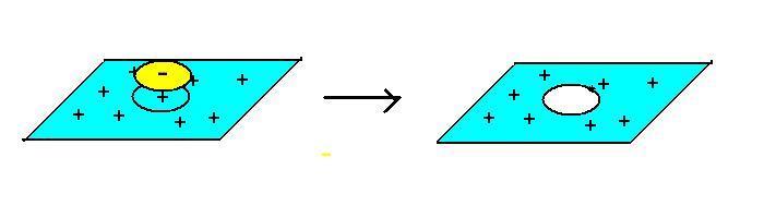

In the figure below, a small circular hole of radius R = 1.80 cm has been cut in the middle of an infinite, flat, nonconducting surface that has uniform charge density σ = 4.50 pC/m2. A z-axis, with its origin at the hole's center, is perpendicular to the surface. In unit-vector notation, what is the electric field at point P at z = 2.56 cm?

I understand how to solve the problem but I don't understand why the charge density of the disk is negative? So why is it -σ? HELP!
The hole can be imagined as a circle with zero charge density. But you can make zero charge density by putting a circle with opposite charge onto the plate, making the charge of unit area equal to σ+(-σ)=0
ehild
ehild
so if the surface has a uniform charge density, then the net charge on the surface is zero?
If the added surface has uniform charge density -σ, the net charge density on the circular area is zero.
ehild

got it, thanks!
