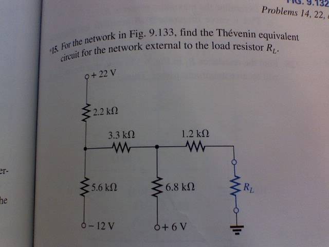

Thevenin stuff, right?

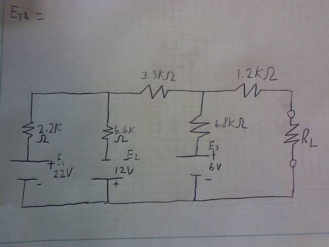

So, I tried to re-write everything and make it a bit easier to understand:
I ended up getting Rth completely fine and everything, but I can't seem to get Eth.
So from there, I figured that I simply do like other problems that have 2 voltage sources. Simply act as if all the other sources are pieces of wire while leaving one at a time actually there, getting the voltage, etc.
The only thing about this is, I assumed that the voltage of AB is the same as the voltage of the6.8K resistor. When I looked over other examples, all of which only had 2 voltage sources, the voltage of AB was simply the voltage of a resistor in the same place that the 6.8K resistor was. But the thing is, in those examples, there were only 2...Not sure if that messes things up =(
So then because E1 had a positive polarity, E2 had a negative, and E3 had a positive, I added E1 and E2, then subtracted E2. When I did this, I simply got the completely wrong answer. Rth was fine, but Eth is just plain completely wrong. The book says that Eth should be 9.74V. I got like 12 something =(
Help? =(

I am not sure what is AB .. you haven't labeled it anywhere.

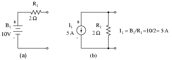

However, one simpler approach I can suggest is to convert each voltage and resistor line to a current source and resistor in parallel. Add up all the currents and add up all the resistors also in ll.. (sorry, missed the 3.3kohm, can do this to the first two wires and then add 3.3.. and do the last wire). I was able to come with 9.76 number (few rounding problems) under 30 seconds through this approach however your approach requires some paper work..

My apologies. I meant to label the two ends of "Rl" as A and B. I was told that using superposition, I am supposed to do that, and find Eth as the voltage between A and B.
So what you did was simply make the first two wires current with resistors in ll? I'll give it a shot! I don't suppose you could post some of the formulas you used?

Your assumption is wrong that E_thevinan is equivalent to the voltage across 6.8 kOhms, it is equal tp the voltage across 6.8 kOhms + 6 V.
