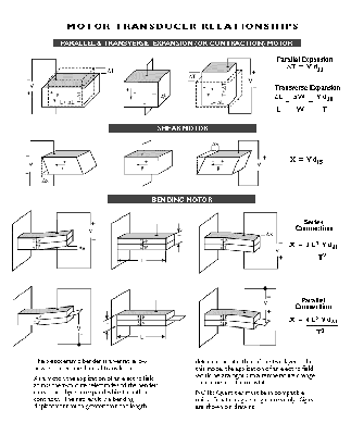

I have some pictures of various arrangments for contraction, expansion, bending, etc. But since 400x400 is the largest I can attach I had to reduce the size and it's not too clear.

Depends on which axis of the crystal the current is applied. I know the attachment I posted is a little small to read but it shows different configurations and the lenght(or angle) vs. voltage.

I looked at your attachment. I couldn't read the words but the diagrams are clear. It showed a cube transformed in various ways by current. By changing the location and direction of the current you could shorten (squash), skew, or bend the crystal. Right?
So the cystal can get shorter or longer depending on the dimension you are considering?
Does the cystal change volume with current? I assume that the degree of the deformation varies with current. Is there a peak degree of deformation (like say 25% or 32%)?
