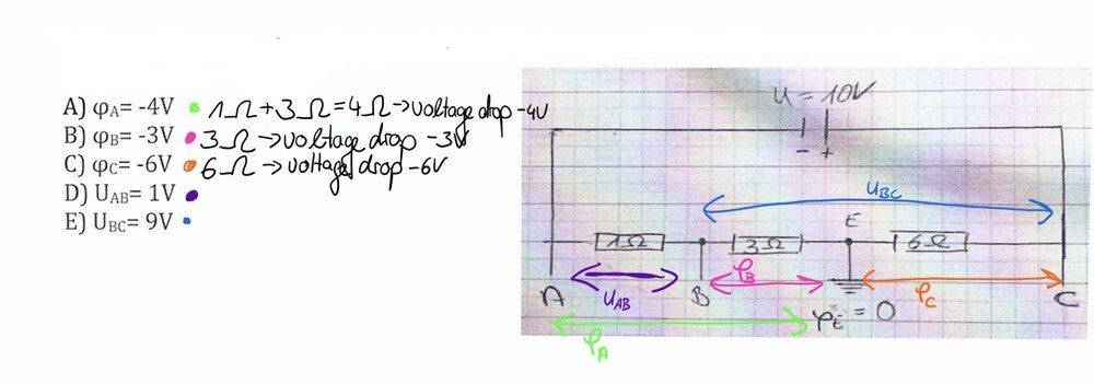

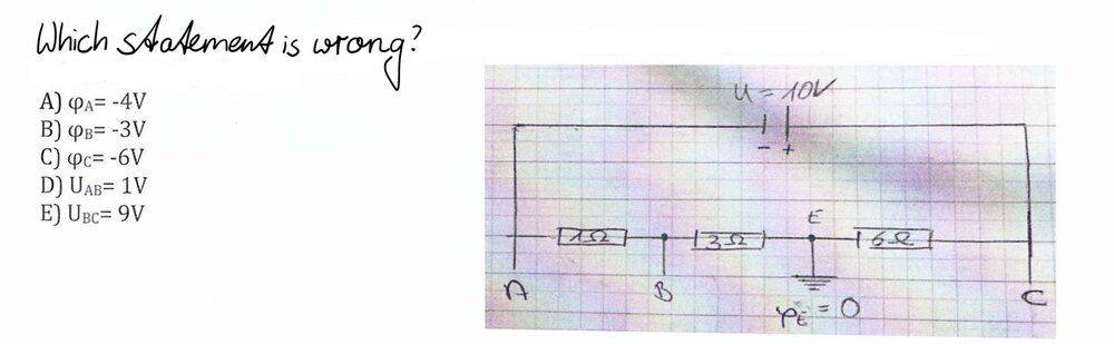

Hey,
I am struggling a bit, als I try to solve this problem - I‘d say all five statements are correct, but it is said, that one must be incorrect
Welcome to PF.
Please explain your reasoning for obtaining values for ##\varphi_A##, ##\varphi_B##, etc.

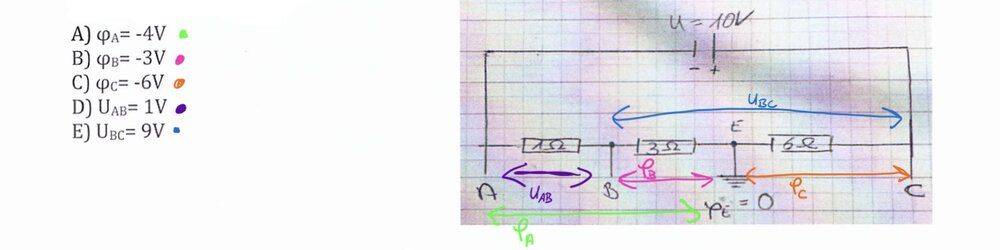

I marked it in the image
this is all I got for this problem
Why do you think that ##\varphi_A = -4## V? What is your thought process for deducing this?
That was my train of thought:
How did you get from a resistance of 4 ##\Omega## to a voltage drop of -4 V? Does a resistance of 4 ##\Omega## always correspond to a voltage drop of -4 V?
No, it does not, but this is multiple choice and I am trying to find the incorrect statement while being very clueless... :(

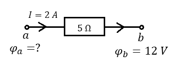

Suppose you have 2 A of current through a 5 ##\Omega## resistor as shown below
The potential at point ##b## is given to be 12 V. Can you figure out the potential at point ##a##?

7 V is incorrect. Does the current play a role in determining the voltage at ##a##?
Hint: Ohm's law

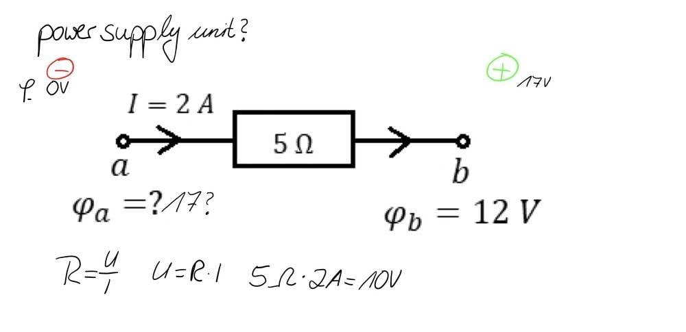

This is the point I got to
to
You correctly applied Ohm's law to find that there is a 10 V drop across the resistor. But how did you arrive at a value of 17 V for the potential at point ##a##?
12+5... I am still not sure if a is 2V or 22V

This is where the direction of the current is important. Whenever current flows through a resistor, the voltage is higher on the side of the resistor where the current enters the resistor. That is, voltage drops as you go through a resistor in the direction of the current.
An analogy might help (but, beware of analogies!). If you have a horizontal pipe full of water and you want the water to flow from left to right through the pipe, then you need a higher pressure at the left end of the pipe compared to the right end.
Likewise, in order for the current to flow from left to right in the 5 ##\Omega## resistor, the potential must be higher at the left side of the resistor compared to the right side.
So it is 22V
AnneX said:
So ist is 22V
Yes. Good. You can see that you had to know the current going through the resistor.

The current, to calculate the voltage drop
Good. You're almost home.
Yes, the potential is given to be 0 at point E.

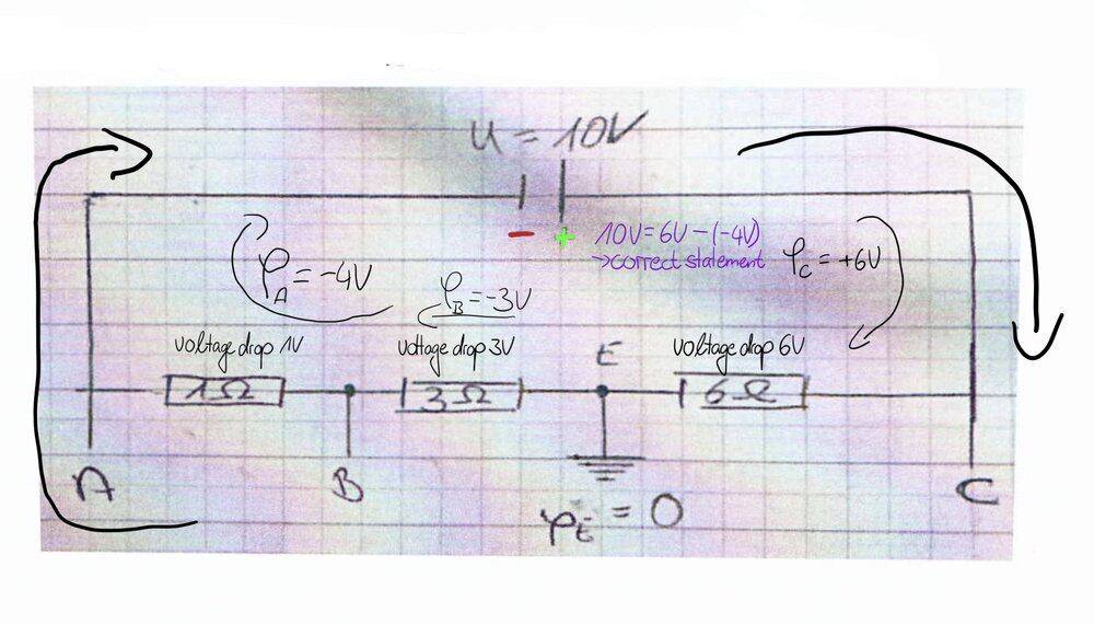

That is what I got: potential a is -4V potential b -3V and potential c +6V, as the flow of current goes from the positive pole to the negative pole - at least that is what I read about it, but I find it kinda confusing
Looks correct. Now you can tell which option is incorrect.
Look up "conventional current" vs "electron current".

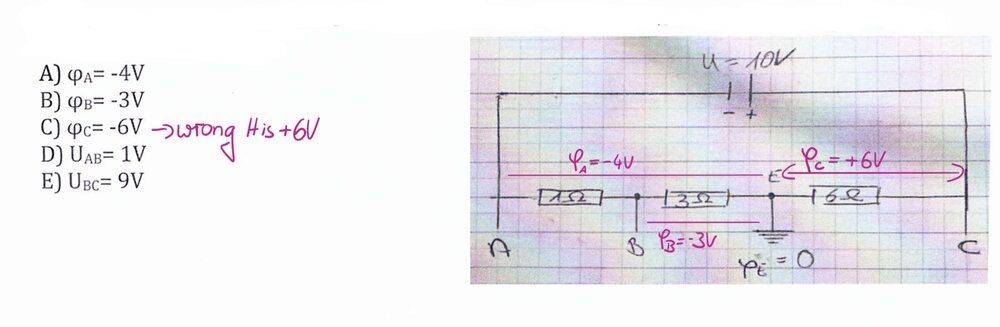

So c is incorrect. But how do I know which one of these two currents applies to a problem?
