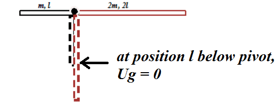

Two uniform bars have masses and lengths of [itex]m[/itex], [itex]l[/itex] and [itex]2m[/itex], [itex]2l[/itex], respectively. The bars are pivoted at the common frictionless hinge as shown. The bars are released from the horizontal position in such a way that they collide and stick together at the bottom position. After that, the bars swing upward together. Find the maximum angle θ the bars would make with the vertical after the collision.
I chose to solve this in 3 steps:
1) Use conservation of energy of C.O.M. of each bar to determine ω of each bar just prior to collision.
2) Use conservation of angular momentum to determine ω of the two bar system immediately after collision.
3) Use conservation of energy to determine final height of the C.O.M. of bar 2, and use that to find θ.

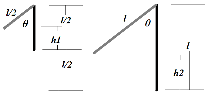

Step 3: Apply conservation of energy to the swinging 2 bar system to determine [itex]h_2[/itex].
This picture shows the change in position of the center of mass of each bar from the collision to the top of the swing. I truncated the 2nd half of each bar to try to simplify the picture. I have drawn both bars separately.
Starting with the 2nd bar:
[itex]l cos θ = l - h_2[/itex]
[itex]h_2 = l - l cos θ[/itex]
Now the first bar:
[itex]\frac{l}{2} cos θ = \frac{l}{2} - h_1[/itex]
[itex]h_1 = \frac{l}{2} - \frac{l}{2} cos θ = \frac{1}{2}h_2[/itex]
Since the C.O.M. of the shorter bar starts at a position of [itex]\frac{l}{2}[/itex] above the reference point,
[itex]h_{1 final} = \frac{1}{2}h_2 + \frac{l}{2}[/itex]Now apply conservation of energy:
