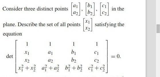

Find elements of a matrix such that its determinant is zero
In summary, the author is trying to find a set of points in which the first column of the matrix is linearly dependent.

Please see the attached file if my inline insertion does not work.

Since a matrix has a determinant of zero only when it's columns are linearly dependent, we look for a set of points [x1 x2] such that the first column of the matrix is linearly dependent. This is about as far as I got and I was wondering if this is the right approach or if there's a much more simpler way to approach this problem.[/B]
Well, linear dependency means what in this case ? That you can write column 1 as a linear combination of columns 2,3,4. What do you get ?
Yes, it means that. [x1 x2] can be any scalar multiple of [a1 a2], [b1 b2], and/or [c1 c2].
Could I say that [x1 x2] is spanned by the vectors [a1 a2], [b1 b2], and[c1 c2]?
That's 2 equations with 3 unknowns. You can pick the first row or the last row for the third unknown.

Column one has four elements. you write down something for two of them only!
When you work out what the three coefficients are
$$\begin{pmatrix}x_1\\x_2\end{pmatrix} = u \begin{pmatrix}a_1\\a_2\end{pmatrix} + v \begin{pmatrix}b_1\\b_2\end{pmatrix} + w \begin{pmatrix}c_1\\c_2\end{pmatrix}$$
2 eqns, 3 unknowns. Not good enough...

Oh! I see what you are saying.
We need one additional equation and that can be obtained by formulating an equation using the 1st row (i.e., 1=u+v+w) or the last column (i.e., ##x_1^2+x_2^2 = u(a_1^2+a_2^2)+v(b_1^2+b_2^2)+w(c_1^2+c_2^2)##)
Yep. There are two more equations, so one of them to solve, the other to find a relationship between x1 and x2.

You might also try the approach of trying to guess what the answer is. If you expand that determinant you are going to get a quadratic form in ##x_1## and ##x_2##. The solution to that is a conic section. Can you deduce enough facts about that conic section to guess what it is without cranking through a lot of algebra? Knowing that might guide you with the algebra. If you deduce enough you might be able to show it without the algebra.
If you people have given up on this you should come back. There is actually a very neat way to solve this one.

I took the determinant of this matrix using matlab.
Here is what I got:
a1^2*b1*c2 - a1^2*b1*x2 - a1^2*b2*c1 + a1^2*b2*x1 + a1^2*c1*x2 - a1^2*c2*x1 - a1*b1^2*c2 + a1*b1^2*x2 - a1*b2^2*c2 + a1*b2^2*x2 + a1*b2*c1^2 + a1*b2*c2^2 - a1*b2*x1^2 - a1*b2*x2^2 - a1*c1^2*x2 - a1*c2^2*x2 + a1*c2*x1^2 + a1*c2*x2^2 + a2^2*b1*c2 - a2^2*b1*x2 - a2^2*b2*c1 + a2^2*b2*x1 + a2^2*c1*x2 - a2^2*c2*x1 + a2*b1^2*c1 - a2*b1^2*x1 - a2*b1*c1^2 - a2*b1*c2^2 + a2*b1*x1^2 + a2*b1*x2^2 + a2*b2^2*c1 - a2*b2^2*x1 + a2*c1^2*x1 - a2*c1*x1^2 - a2*c1*x2^2 + a2*c2^2*x1 - b1^2*c1*x2 + b1^2*c2*x1 + b1*c1^2*x2 + b1*c2^2*x2 - b1*c2*x1^2 - b1*c2*x2^2 - b2^2*c1*x2 + b2^2*c2*x1 - b2*c1^2*x1 + b2*c1*x1^2 + b2*c1*x2^2 - b2*c2^2*x1OUCH! There must be an easier way to do this.

Yes, there is a much easier way. Your expansion is quadratic in ##x_1## and ##x_2##. Where it's zero is a conic section as I said before. I.e. it's an ellipse, hyperbola, etc. That narrows it down a bit. Now go back to thinking about the determinant. Can you name three points on the conic section by thinking about the determinant? Can you narrow down the form of the conic by thinking more about the coefficients of the quadratic terms?

I mean that it is like ##x^2+y^2=1## is a circle. And ##x^2-y^2=1## is a hyperbola. Like conic sections. You must have done these at some point. Try to visualize the graph in ##x_1## and ##x_2## like it's a graph in ##x## and ##y##. All the terms have degree 2 or less. It must be a conic section, yes?

ALL of terms put together represent a conic section. It has the form ##Ax_1^2+Bx_1x_2+Cx_2^2+Dx_1+Ex_2+F=0##, yes? Where the constants are combinations of a's b's and c's? What is B? That's a start.

Look through your expansion. Do you see any ##x_1 x_2## terms? Think about the determinant if you want an even better reason.

Exactly, use properties of the determinant to figure out stuff about the conic. Any points you can think of that are on the conic?

Okay, so the equation becomes:
##Ax_1^2+Cx_2^2+Dx_1+Ex_2+F=0##
I found this online
##B^2 - 4AC > 0##, hyperbola
##B^2 - 4AC = 0##, parabola
##B^2 - 4AC < 0##, ellipse or circle (circle only if B = 0 and A = C)
B=0, so we have to find A&C, to determine the form of the conic section.

You could look at your expansion to find a relation between A and C. What is it? But you could also determine that just by looking at the matrix you are taking the determinant of and figuring what factors multiply ##x_1^2## and ##x_2^2##. Think about expansion by minors. Once you've figured out what kind of conic you have - you still need to know some points it passes through to determine the conic. That's a separate issue - but again there's an obvious answer by staring at the unexpanded determinant.

Oh got it, from looking at the unexpanded determinant (and later verified by looking at the expanded determinant), I see that the following coefficients for ##x_1^2## and ##x_2^2##
For ##x_1^2##, there is ##-a_1b_1, a_1c_2, a_2b_1, -a2c1, -b_1c_2, b_2c_1## looks like just (# of points factorial, i.e., 3!).
For ##x_2^2##, there is ##-a_1b_2, a_1c_2, a_2b_1, -a2c1, -b_1c_2, b_2c_1## looks like just (# of points factorial, i.e., 3!).
So it is the same for both ##x_1^2## and ##x_2^2##.
So ##A=C=-a_1b_1+a_1c_2+a_2b_1+a2c1+b_1c_2+b_2c_1##.
So this is a circle.

Well actually, it's probably got something to do with (from a purely linear algebra perspective without considering geometry) linearly independency and if the set of x points equals the set of a, b, or c points, we'd get a 0 determinant.
So I'm guessing we can get 3 set of points right away that ##[x_1, x_2]=[a_1, a_2] or [b_1, b_2] or [c_1, c_2]##

So far so good. Yes, it's a circle. Now think about linear dependence. Suppose ##[x_1,x_2]=[a_1,a_2]##?

Right, it's the circumcircle of the triangle formed by a,b and c. Can you figure out how to do this without using the tedious expansion of the determinant?

No, the triangle is a given. ##a##, ##b## and ##c## are ANY points.

After I find the coefficients, A, C, D, E, and F, I will have some equation that describes a circle. Does this equation by itself satisfy the requirements of the problem, where I am asked for ##[x_1; x_2]##? The equation for the circle will be an implicit equation.

The problem says 'Describe the set'. If I were grading the problem, the description of the set as the circle that passes through the points ##a##, ##b## and ##c##, along with the reasons you think so would be enough. I don't think the actual equation of the circle is needed.
