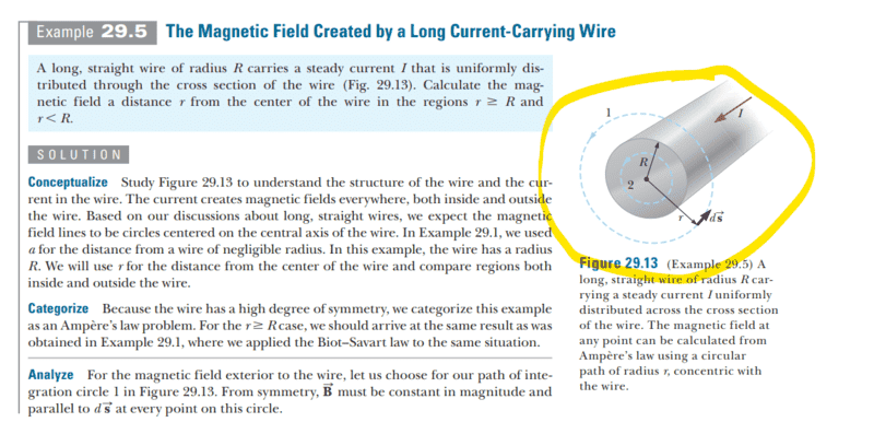

Length element in Ampere's law
In summary, the length element (vector ds) perpendicular to the current is due to the plane of the circle in which it lies being perpendicular to the current.
Nway
34
Problem below
Problem below
Why is the length element (vector ds) perpendicular to the current?
I though length element should be parallel to current.
Would anybody be kind enough to help.

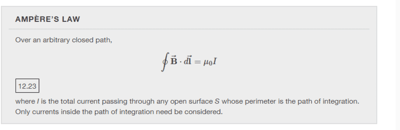

Please give your textbook's statement of Ampere's Law .
Likes Nway
Ok I'll find it.
Where ##\vec{ds}## is equivalent notation to ##\vec{dl}##
Your textbook uses ##\vec{dl}## for a length element. The textbook should provide some explanation of the meaning of the integral on the left side of Ampere's law. Hopefully, the book also has some figures that help illustrate the meaning of the integral. This video might help.
Because the plane of the circle in which this element lies is perpendicular to the current. Any vector lying in that plane has, by definition, no component parallel to the current.

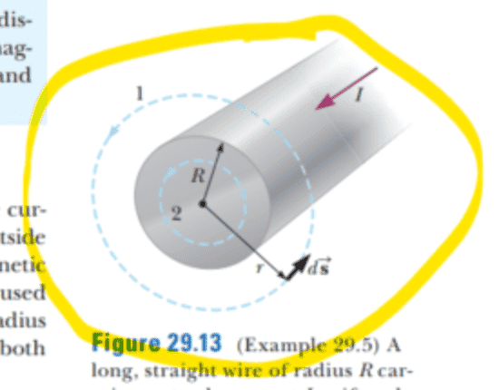

Sorry sir. What do you mean the plane of current? I don't understand because when there is a current in a wire like here:
the vector ##\vec{ds}## is parallel to current. I know that the vector perpendicular to the current will have no component parallel to current. However, why is that vector not parallel to the current like in the image above?
The direction of the vector ##d\vec{s}## depends on the path of integration. It is not related to the current, in general. In your problem the integral is along a circular loop. The plane of this loop is perpendicular to the current. There was no mention of the "plane of the current". @kuruman wrote "the plane of the circle". The circle is this loop along which the integral is done. You can see this in the figure in the OP. The blue circle with dashed line. This is the integration path and ##d\vec{s}## is tangent to this path at any point.

Look at what Ampere's law says. You are not integrating along the current carrying wire. The wire passes through an open surface. The line integral is along a (closed) path which is along the boundary of the open surface.
This is NOT the Biot–Savart law which has you integrate along the current carrying wire.

Sir thank you. I assume that ##d\vec{s}## has same meaning for Ampere's law as with Biot–Savart law? I am now correct to say that ##d\vec{s}## gives direction of path at each differential point along a path.
However I feel confused about that ##d\vec{s}## would be tangent to circular path. Why must this be true?

That's a different ##d\vec s## from the one you asked about in the original post. Look at your picture below that you yourself circled in yellow. It shows a circle defined by a blue dotted line and current ##I## with an arrow in the direction of the current. The current is perpendicular to the circle and to all vectors in the plane of that circle including the ##d\vec s## shown therein.
The generic directed length element ##d\vec s## is given to any path. It could be in the same direction as the current or perpendicular to the current. It could have no relation to current when you are writing the work done by a force along a path as ##W=\int \vec{F}\cdot d\vec s.##

Thanks sir. So why dose ##d\vec{s}## have to be perpendicular to the current (in the plane of the circle)? Maybe a better restatement of my confusion: Is there a generalized definition for ##d\vec{s}## that is is Bio-Savart and Ampere's law?
The only definition for ##d\vec{s}## that I'm aware of is from the work equation. Where ##d\vec{s}## is the differential displacement due to a force ##F##. However, I don't see that definition solve my E&M confusion.
It does not have to be in any way. It is up to you to choose the integration path according to the problem you try to solve. ##d\vec{s}## is the path element for any path, no matter what is the problem to be solved. You pick the integration path to solve the problem, usualy to solve it in the easiest way. You need to understand how the laws used (here Biot-Savart and Ampere) work in order to understand how do you choose the integration path. Once you do that, you don't have to make any choice about ##d\vec{s}##. It is tangent to the chosen path.

Thank you very much sir. I still don't understand why ##d\vec{s}## is tangent to path. It is similar to how the velocity vector is tangent to a circular path in uniform circular motion?
Yes, it is similar to that.
