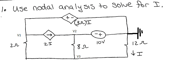

Nodal Analysis Help, 1 equation 2 unknowns

1.
2. V=IR, Nodal analysis
3. Based on where I have drawn my ground, V2=-10V, V1=3I. From this I should just have 1 equation with 1 unknown (if I have done this correct). My KCL equation for node V1 is (V3+10)/8 + (V3-3I)/2 + V3/12. I am stuck, I need to find an equation for I in terms of V3.
If you assume the potential at v3 is, well, v3, then what's the current through the 12Ω resistor?
Likes 1 person
Oh wow, I=V3/12
eatsleep said:
Oh wow, I=V3/12
Watch the sign...
