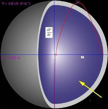

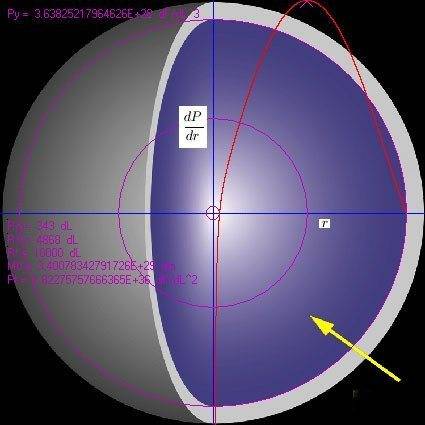

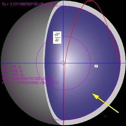

The TOV equation should be:
[itex]\boxed{\frac{dP}{dr} = -(P(r) + \rho(r) c^2) \left( \frac{4 \pi G r^3 P(r)}{c^4} + \frac{G m(r)}{c^2} \right) \left[ r \left( r - \frac{2G m(r)}{c^2} \right) \right]^{-1}}[/itex]
The TOV equation solution for a Neutron Star:
[itex]\boxed{u = \frac{r_s}{2}}[/itex]
[itex]\boxed{\frac{dP}{dr} = -(P(r) + \rho(r) c^2) \left( \frac{4 \pi G r^3 P(r)}{c^4} + \frac{r_s}{2} \right) \left[ r \left( r - r_s \right) \right]^{-1}} \; \; \; (r > r_p) \; \; \; r \neq r_p[/itex]
Integration by substitution:
[itex]\boxed{\frac{dP}{dr} = -(P(r) + \rho(r) c^2) \left( \frac{4 \pi G r^3 P(r)}{c^4} + \frac{G m(r)}{c^2} \right) \left[ r \left( r - \frac{2G m(r)}{c^2} \right) \right]^{-1}} \; \; \; (r > r_s) \; \; \; r \neq r_s[/itex]
The TOV equation solution for a Black Hole:
[itex]\boxed{r_s = r_p}[/itex]
[itex]\boxed{u = \frac{r_p}{2}}[/itex]
[itex]\boxed{\frac{dP}{dr} = -(P(r) + \rho(r) c^2) \left( \frac{4 \pi G r^3 P(r)}{c^4} + \frac{r_p}{2} \right) \left[ r \left( r - r_p \right) \right]^{-1}} \; \; \; (r > r_p) \; \; \; r \neq r_p[/itex]

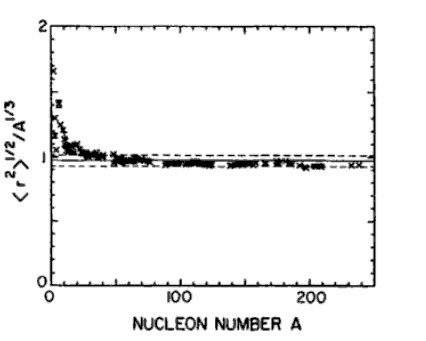

Neutron average density:
[tex]\rho_n = \frac{m_n}{V_n} = \frac{3 m_n}{4 \pi r_n^3}[/tex]
Neutron radius:
[tex]r_n = r_0 A_n^{\frac{1}{3}}[/tex]
[tex]r_0 = 1.25 \cdot 10^{-15} \; \text{m}[/tex]
Neutron atomic mass unit mass:
[tex]A_n = 10^3 N_A m_n[/tex]
[tex]N_A[/tex] - Avogadro's number
[tex]\rho_n = \frac{3 m_n}{4 \pi ( r_0 A_n^{\frac{1}{3}} )^3} = \frac{3 m_n}{4 \pi A_n r_0^3} = \frac{3 m_n}{4 \cdot 10^3 \pi N_A m_n r_0^3}[/tex]
Neutron density:
[tex]\boxed{\rho_n = \frac{3 m_n}{4 \cdot 10^3 \pi N_A m_n r_0^3}}[/tex]
[tex]\boxed{\rho_n = 2.0297 \cdot 10^{17} \; \frac{\text{kg}}{\text{m}^3}}[/tex]
Neutron star density function parameters:
[tex]\rho(r) \; \propto \; \int_{\text{1E9}}^{\text{8E17}} \; \frac{\text{kg}}{\text{m}^3}[/tex]
Neutron star average density parameters:
[tex]\rho_t \; \propto \; \int_{\text{8.4E16}}^{\text{1E18}} \; \frac{\text{kg}}{\text{m}^3}[/tex]
