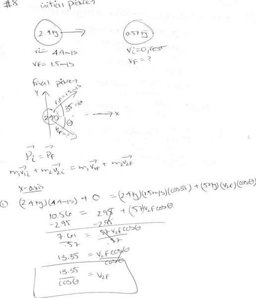

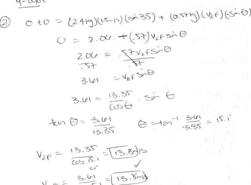

Ok, I figured it out! My professor went over it in class and here's my work:
Sorry if you can't read my handwriting!
Sorry, I've been away for a couple of days. But your work looks right to me!
