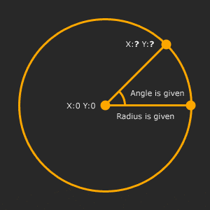

Hi.
If the radius of a circle is known and it's also known that its center is at X:0, Y:0, how can the points that form the circle be calculated? What would be the coordinates of a random point of the circle?
I made a simple illustration hoping that it would make the question a little clearer.
Any help would be fantastic.
Thank you!

theres an equation for this
That's great! I'd love know what would be that equation.
I found the following:
In an x-y coordinate system, the circle with centre (0, 0) and radius r is the set of all points (x, y) such that:
{x}^2+{y}^2={r}^2
But I'm not sure how to find the coordinates of a random point using this formula.
That depends strongly on what you mean by "random". You could, for example, choose x "randomly" (uniform distribution) between -r and r and then calculate y by y= \pm\sqrt{r^2- x^2}, choosing the "+" and "-" randomly with probability 1/2 for each.
A different way would be to use the "angle", \theta. Choose \theta randomly (uniform distribution) between 0 and 2\pi. Then use the formulas x= r cos(\theta), y= r sin\theta. Notice that since sin^2(\theta)+ cos^2(\theta)= 1 that gives the same as x^2+ y^2= r^2.
This is, by the way, for a point on the circle, not a point in the disk. In order to choose points "randomly" in the disk x^2+ y^2\le R^2, choose two numbers, r chosen randomly between 0 and R, \theta chosen randomly between 0 and 2\pi and then use x= r cos(\theta), y= r sin(\theta) to find the point (x,y).
i took the statement to be " find an arbitrary point"
Thank you very much HallsofIvy, that's really helpful!

Halls, you didn't specify how to choose r between 0 and R. Assuming you meant a uniform distribution, the selected points will not be uniformly distributed on the disk. Choosing r2 randomly between 0 and R2 will result in a uniform distribution over the disk. Another approach is to choose x and y randomly between -R and R. Repeatedly draw pairs until x2 + y2 < R2.
