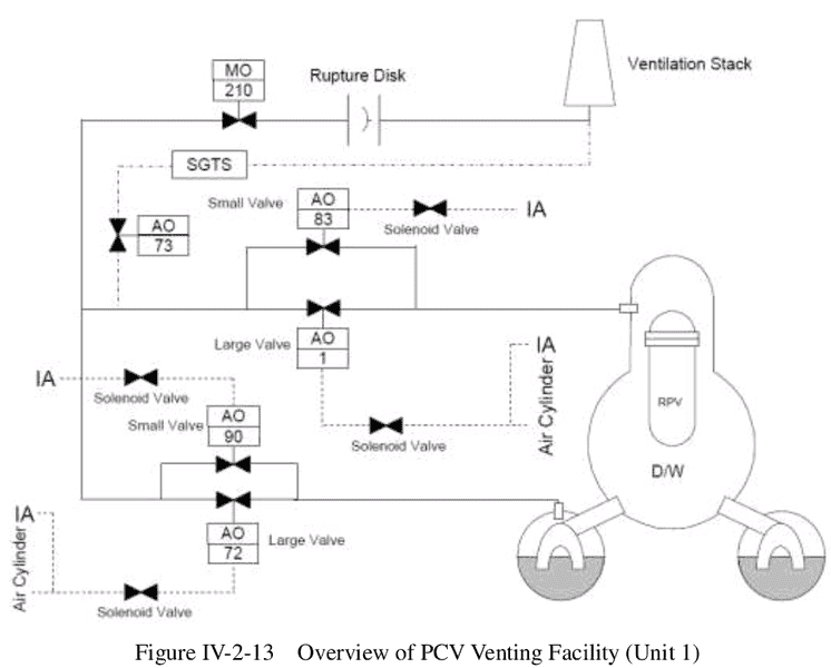

  • #10,831
AtomicWombat said:
Are the AO valves fail-open or fail-shut?
The AO valves would be fail-shut.
In figure Figure IV-2-13 Overview of PCV Venting Facility (Unit 1) on page 154 of your linked document there is only one MO (manually operated) valve in the path to the stack and one rupture disk - presumably set near the wet-well maximum operating pressure.
Yes, that all seems consistent with the testimony/evidence of the reports.
At 9-11 minutes into this video David Lochbaum says that the operators manually openned the hardened vent valve.
http://vimeo.com/26231562"
I get from the testimony, that the operators on preparation of the vent procedure found that the MO-valve (Motor Operated) was designed such that it was possible to operate it manually, whereas the AO valves (Air Operated) could be operated only remotely using air pressure, not manually. In order to make a functioning vent line, they needed to open the MO valve, while keeping open either or both of the two AO valves. Once this configuration had been lined up, and as long as it could be kept lined up, actual venting would be triggered at the set value of the rupture disc.
  • #10,832
Thanks MD, I've lost track of events. Do you have a link for the testimony?
Is it known if the "hardened vent" is still open?
If the air-operated valve is fail-shut then it would only have staid open if compressed air had been fed to it for 4 1/2 months. So I wouldn't have thought so, unless something malfunctioned.

MadderDoc said:
(http://www.ansn-elibrary.org/images/c/ca/Boiling_Water_Reactor_Power_Plant.pdf" )
afaik this system may have rather low throughput and could not be used in the event of serious emergency. But that may depend to particular reactor.

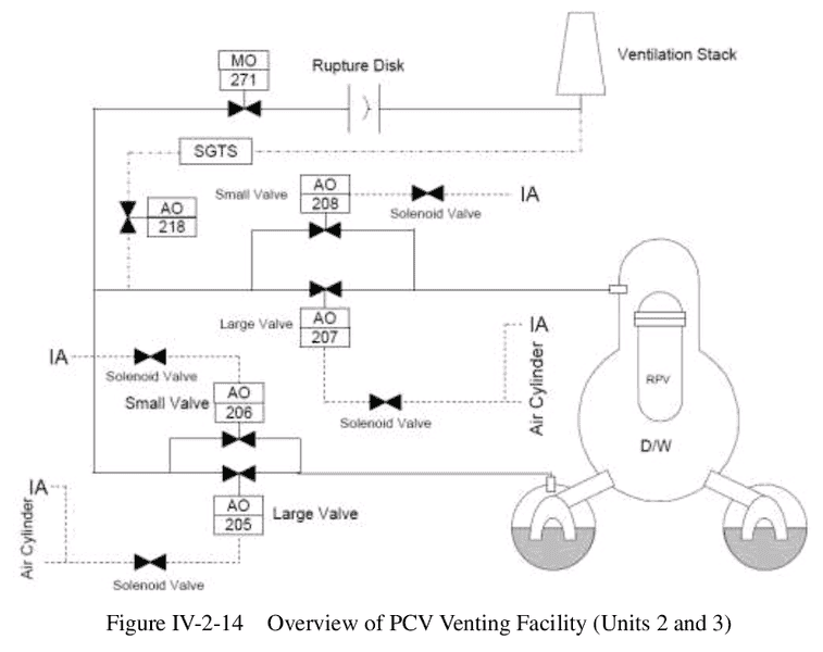

Yes, in all likelihood the venting systems used by the operators were not the Emergency Gas Treatment Systems, but rather the retrofitted hardened vents we have been talking about. Here's the unit 1/2/3 diagrams of the hardened vent lines cropped from the report of the Japanese governement to the IAEA (see attachments for better rendering):
