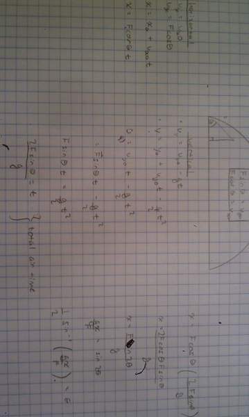

I just got curious today and tried to determine the angle a sniper must make with his barrel to hit a target over some distance, neglecting air resistance, humidity, etc. Any suggestions as to why my solution on the bottom right is wrong?
You have y=yo+vo t - g t^2/2 and then you have 0 = vo t - g t^2/2 so that means y=yo always, and that's not what you want.

Yes, I did this to solve for T. Afterwords I multiplied that formula by 2 in order to determine the total air time. Once I found the total air time formula T= 2Fsin(θ)/2 I plugged it into the formula X = X° + Vxo * T. Was this an incorrect strategy?
But if you say that y=y0, that's wrong. You are saying that the y coordinate never changes, always stays where it started from. If you make that wrong assumption, you are bound to get wrong results.
He substituded 0 for y_0, because y_0 happens to be 0, and then set the remaining expression for y equal to 0. There's nothing wrong with that
However, there's an error (or even 2 errors) between
x = \frac { 2 F \cos {\theta})F \sin {\theta} } {g}

jsewell said:
How might you have it willem2?
I get
x = \frac {F^2 sin {2 \theta}} {g}
and
x = \frac {F \sin {2 \theta} } {g}
Ok, I see, the t is the t when the bullet hits the aim point.

Yes willem2 I did reach that formula after some revisions. I didn't square the Velocity of the projectile (bullet). Although after solving the same equation for theta are you able to reach my formula of
(1/2)(arcsin(XG/V^2) = theta
