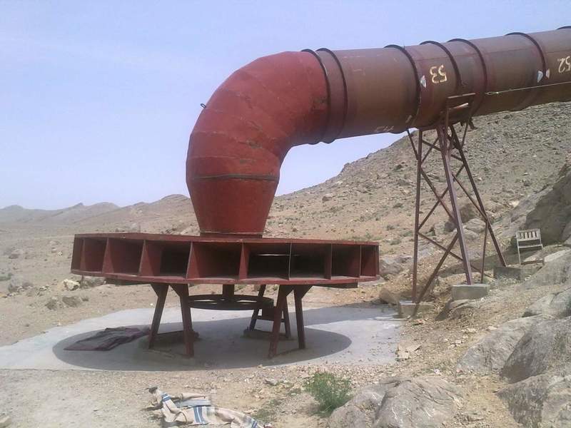

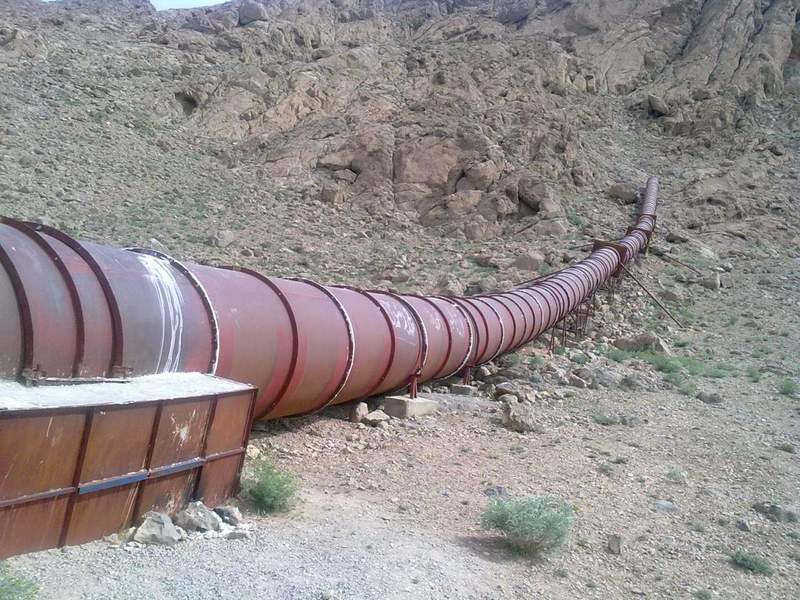

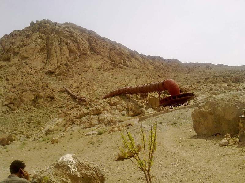

Can anyone help me to find how much wind or air is required to rotate turbine of 7.5 feet diameter to produce 1 rpm
The blade tip speed has to be at least equal to the wind speed. 1 RPM is equal to 0.1 radians per second. Because the blade radius is about 1 meter, the wind speed should be at least 0.1 radians/sec x 1 meter/radian = 0.1 meters/sec..
You should have a wind speed of at least 5 meters/sec. Using a blade area of A = pi R2 = 3.14 meters2, the output power would be (using efficiency η = 0.25)P=\frac{1}{2} \eta \rho A v^3 = \text { 0.5 x .25 x 1.2 x 3.14 x 5^3 = 60 watts}
This is barely enough to overcome friction.
thanks a lot for your kind reply
it is a kind of vertical turbine with chimney of 500 ft .so we think this chimney connected to it will cause some suction which will also increase its wind speed.
i have sent one attach file please see it and reply me .i will be waiting for your kind reply
So you are describing a vertical chimney with a vertical-axis wind turbine inside? What is the diameter of the chimney? Is it similar to the large cooling towers used by electric utility plants? See http://www.picture-newsletter.com/nuclear/cooling-tower-01.jpg
the turbine is not in chimney it is in casing from which the chimney of 5 feet diameter is going up word it is basically near mountain and the chimney is you can say going upward on mountain i have tried to describe little in this file
sir i am waiting for your kind reply.........
sir i am sending some pic of the turbine pleasezzzzzzzz see and answer for question
