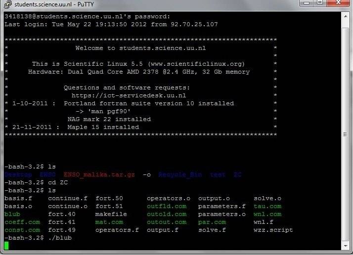

I am using a makefile and the file is compiling without any errors. After compiling I try to execute the output file by typing ./output, but then the bash shell thing disappears and I can only type text but not give commands anymore. Anyone know what could be going on?

Thanks for the help. I haven't figured it out yet so I'll show what I have, maybe you have an idea.

I would look at the .f files (the source code) with a text editor (or just use the 'cat' or 'more' command in the shell) and see if they contain comments that explain the operation of the program. I can't tell which one has the main program, but there are only seven files to look through.

A few 'grep' commands on your files reveal quite a few things...
  • first, it shows that the main program is continue.f
  • that *.com files are variable declaration along with common blocks and are included here and there
  • that the 'read' command shows up only half a dozen times and it attempts to read from unit number 4
  • and it does not look like unit 4 is ever initialized
  • in my book, typical standard channel in fortran are 0, 5, and 6...no 4
  • could it be that by default it attempts to read from fort.4? Is that a file that needs to pre-exist to program execution...I could test that, but I won't...maybe you should.
  • I would put a 'write' statement BEFORE every "read(4," command to see if I get there and see if that is the reason why the program is waiting for something that is not getting.
