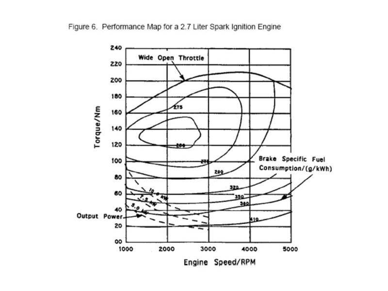

13 liters per 100 km vs 8 liters per 100 km is not a marginal difference. It is 63% more fuel. Gasoline engines typically are most efficient (about 30%) when operating at about 80% of maximum torque and 30% of redline. By efficiency I mean fuel consumption rate per horsepower output. This is actually measured with a dynamometer on the engine, and the measurement is grams of fuel per kilowatt-hour output. A good engine might use 240 grams per kilowatt-hour. If you put either of these engines in the same car, you will find that the larger engine is running further away from the maximum efficiency point, and is therefore less efficient. See attached BSFC map for a 2.5 liter engine. Ask for one at your automobile retailer.

If you put either of these engines in the same car, you will find that the larger engine is running further away from the maximum efficiency point, and is therefore less efficient. QUOTE]

Another drag is running an IC engine at high manifold vacuum. This is work the the pistons have to do against the ambient air pressure on the intake stroke. Adiabatic expansion of the air under these conditions cools the air, which adversely affects the engine performance. This is why the torque for most efficient engine performance is about 80% of max torque, at any RPM.

Compare to the BSFC map on my earlier post.
