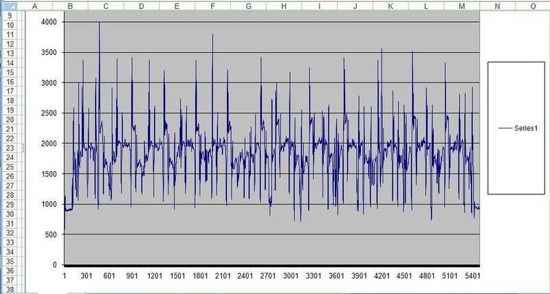

My city cycle is approx 58% better and I have a tacho graph see below.

The city test was done driving arround the block 12 times and at speeds of 50 60 70 km/h see post with graph.
Some rough stats from the data based on engine rpm, crusing 82.61%, idle 7.41% rpm above 2440 rpm 9.94%.
I also calculated when the acceleration rate exceeded a threshold eg when in lower gears accelerating the figure is 19.49% of the time the engine was running during the test.

That doesn't sound much like city driving to me - how often did you come to a complete stop?

For the city test that I did, I drove arround the block 12 times, 6 laps turning right and 6 laps turning left so I would cop the stop signs on 1/2 the journey and doing 67 km in one go.
Acording to my tacho graph my engine was idleing for 7.41% of the time I think this is a bit low but I can not find a standard anywhere to test my car against eg the amount of idle time I think it should be neer 15%, that's easy to derate my figures
the test ran for 91 min and I am short 7.59% so say 7 min at 10 cc/min I used 4.76 L in 91min +70cc any way about 7.184 l/100km

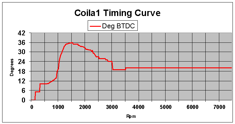

And I could just add that this is my second prototype my first one used to knock when the timing was fired 4-5 deg before top dead center above 3000 rpm with no load, I ended up destroying it before I could fix the timing problem later on I threw it out.
There is no way it should have been knocking with that little timing at 3000 rpm and no load.
It was knocking and the spark plugs would only last 3-4 days
see http://www.youtube.com/watch?v=XnwJuNbvULY" for a look at my plugs back in 2002.
This is the timing of my first engine http://ampair.tripod.com/Graph/My_first_engine.html"
The 1st and 2nd graphs would stop my engine knocking but the power level was low.
The 3rd and 4th are when I lowered the compression ratio to 8:1.My second engine timing plots at http://ampair.tripod.com/Graph/My_second_engine.html"
note notice how there is no bend at 3000 rpm.
Over time my timing base line seems to go lower.
I think its due to carbon build up.

I came to a complete stop roughly 28 times the data log is a bit coarse

3. This is a later program after I lowered the compression to 8:1 Look at where the advance peaks its about 1500 rpm then it goes negative this is not normal unless you have a large super charger feeding the engine.
4. After a while I got the feel for the timing the blue line is a guess below 3000 RPM because the mechanical advance was fine until 3000 rpm under load I have no idea what the timing should be of my first engine well if its anything like my second engine its about 20 degrees retard with full load but it was knocking at no load so I would have to find than figure out one day when I want to end the life of my engine to get some idea of what it should of been. I do agree it would be very different to find the timing because the piston is moving away eg the space is getting bigger instead of surviving getting smaller.

If you check my timing line in my second engine on my forum http://203.161.71.130/forum/topic.asp?TOPIC_ID=23" you will notice is a 1 dementioned
line unlike a modern engine which is 2 and if I heat my engine up a little it needs to be 4 deg lower at low rpm.

I can only video my fuel consumption test at idle and maybe higher rpms, I have done road tests also with greatly improved results but I do not have a comparison engine, that was left behind at my last girlfriends place because the police insisted on a court order for me to get my stuff from her place.
I have worked out something from a drive around the block.
I used an average of 42 cc/min of fuel and my average rpm was 1719.
From that data my engine and a normal engine software I worked out this.
My engine uses 7.8 kw of fuel 42 cc/min to run at 1719 rpm eg normal city loads for 99.5 min
Thus VE% of my engine is 25% How does that compare?
